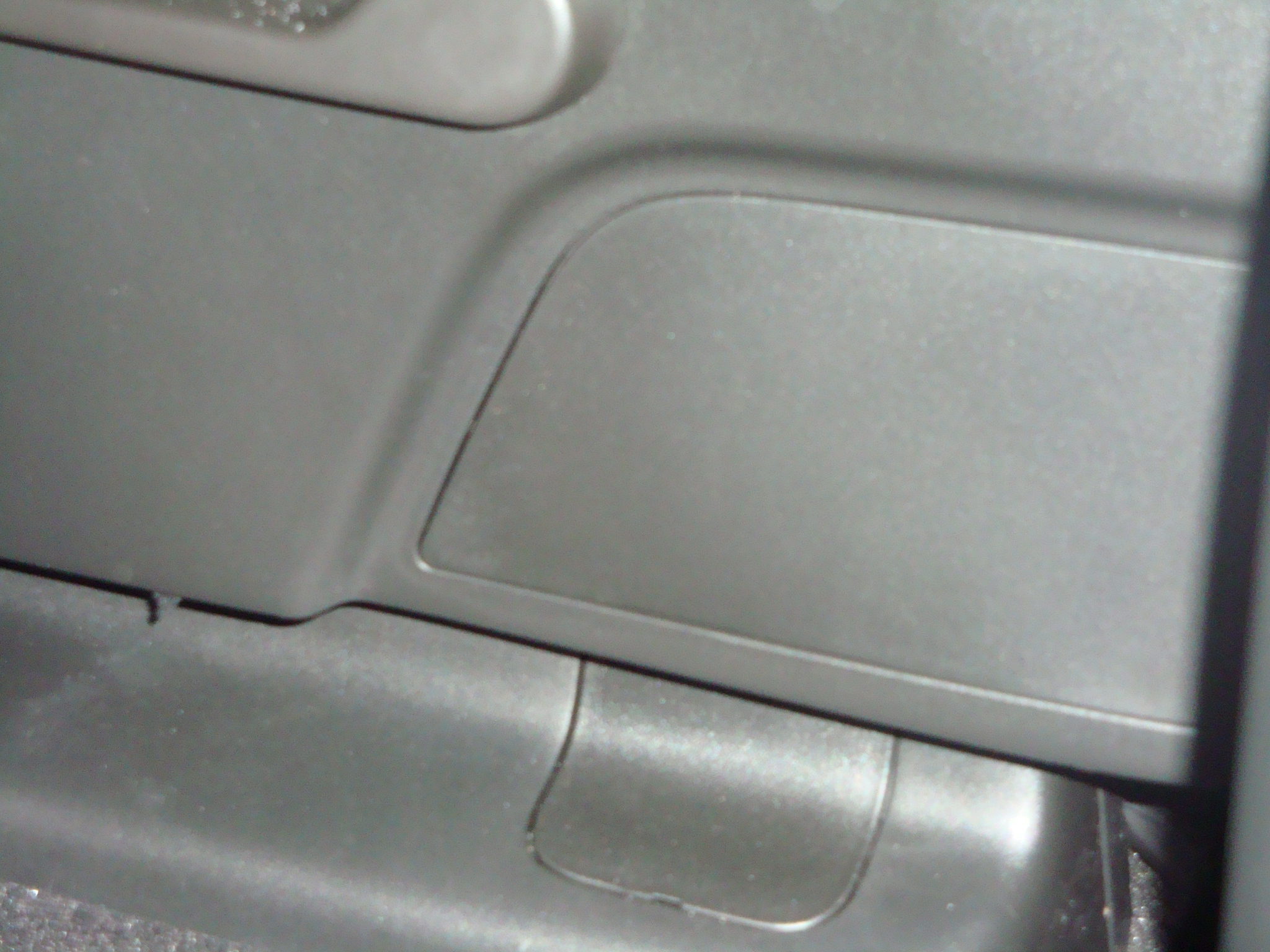

In one of my posts I had talked about a door rattle I had. Well I took the door panel off and added some felt to the area I thought the rattle was coming fromthis past weekend. It didnt work. Last night I played around more and found exactly where it was coming from. It was coming from the trim on the seat. I popped off the cover (see photo) and put some felt next to the seat belt bolt (rubbed on the plastic) and where the plastic clip went in. Its all hidden so you cant see it. I would have sworn the noise was in the door panel by the window but it was actually down low and resonating upwards. Hope this helps. I again have a silent cab for the time being :lol:

The passenger seat lumbar adjustment motor wiring harness flopped against the plastic panel on back of the seat in mine. Carefully removing the panel I discovered two holes in the the seat metal frame for clips taped in the harness to be inserted in. Problem was whoever taped up the harness placed the insert clips in the wrong place, and left them that way. Nothing though that a razor knife and being careful not to cut the wires, I repositioned the inserts , taped back up with 3M 33 Electrical Tape and attached to support holes. Problem solved, no more rattling from seat every time I hit a bump in the road.

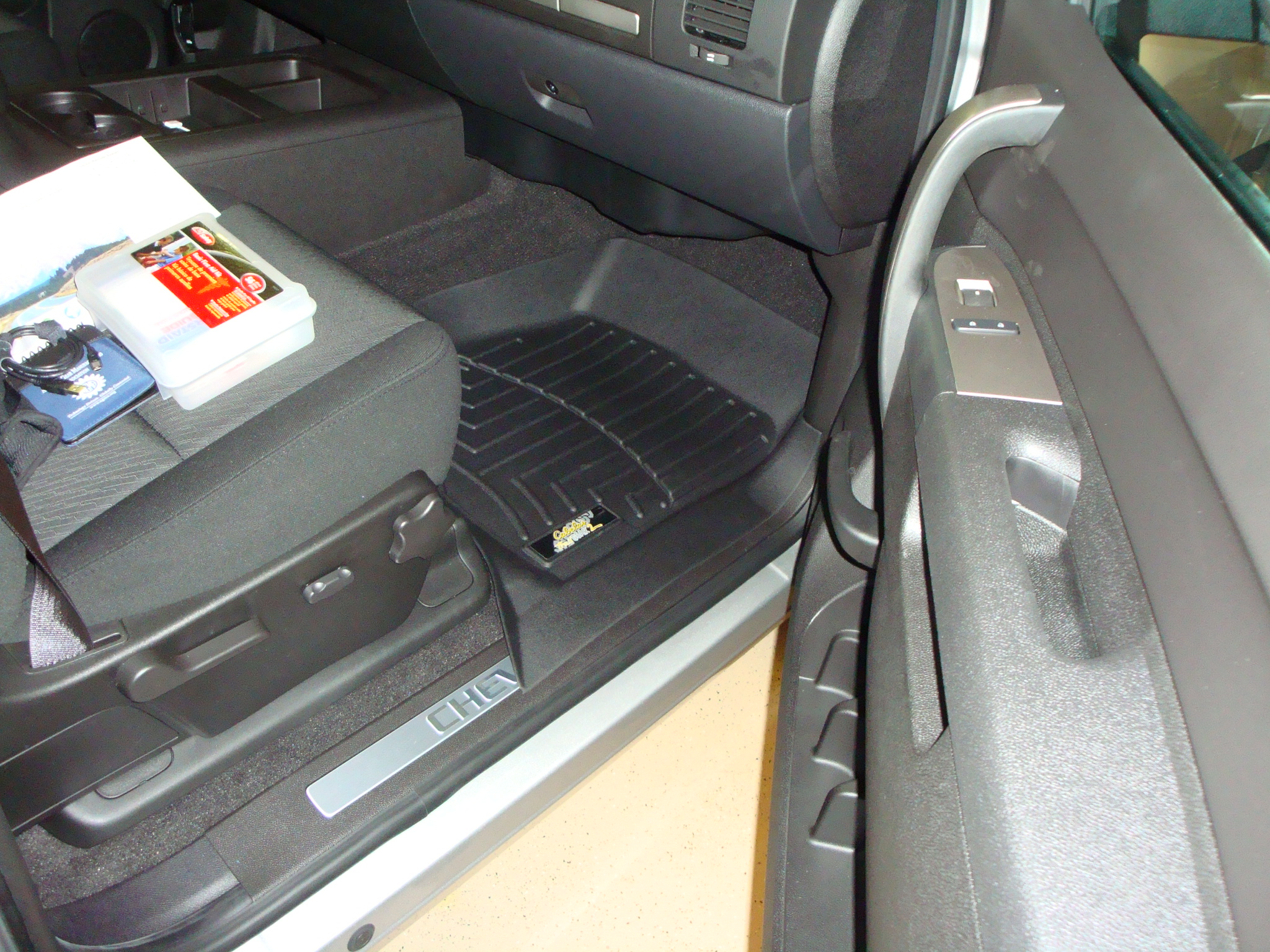

Sorry, this is completely off topic, but I noticed in the second pic that you have an aluminum picece that says chevrolet on the door sill. Is that factory and is there one up front too?
Yes it is part of the WEA (Z71) appearance pkg
What do you mean by up front? That is the drivers side door sill. They are also in the back pass doors also
In another topic MSDALE posted part numbers. Search for 2010 truck Pics
Here is another photo of it, front and rear
Here are the part numbers courtesy of MSDALE
