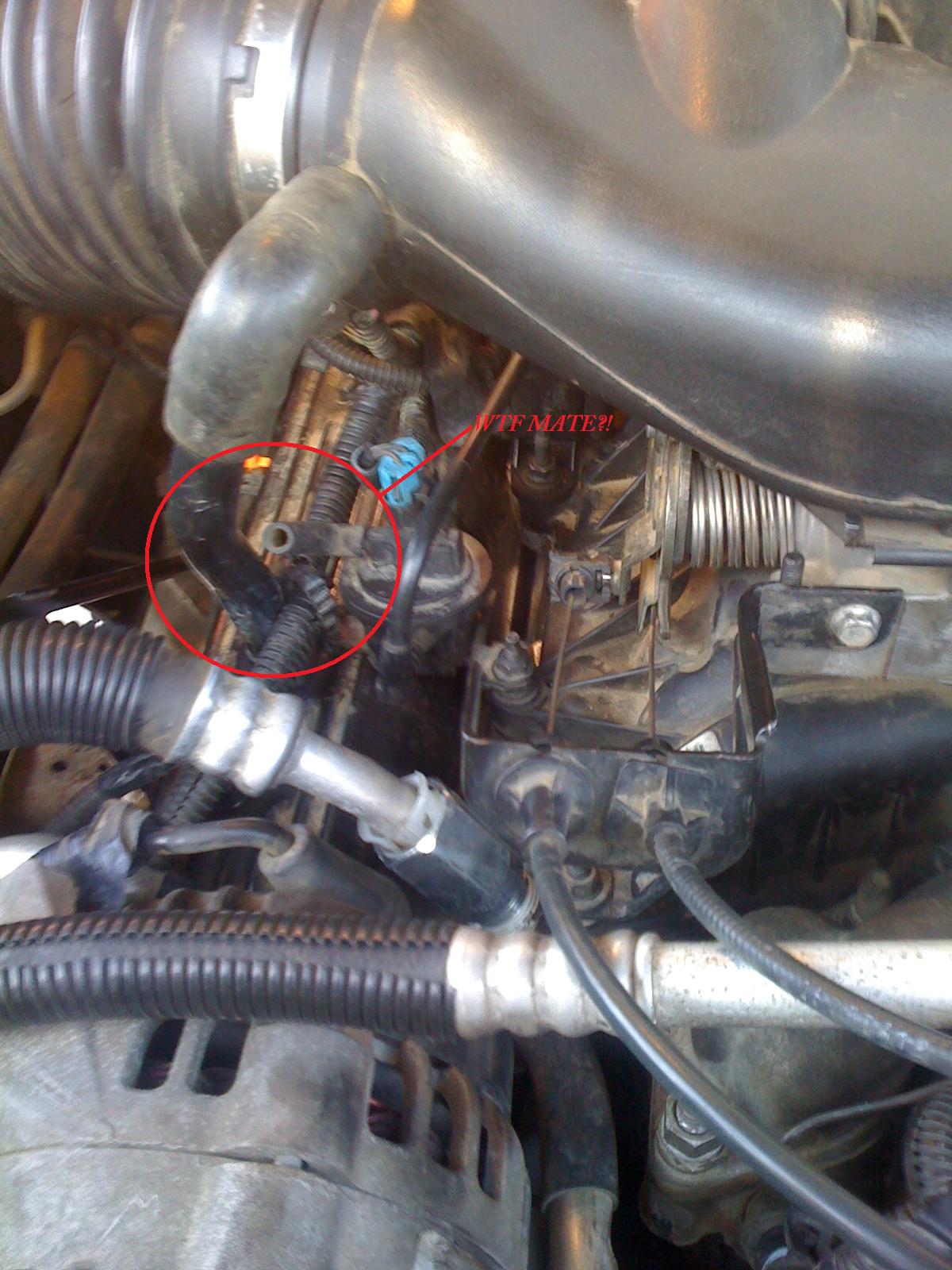

What Is This And Whats It Doing To My Truck ? Pic
roperninja
?! 1997 vortec 350 z71
Also where are my cruise control units? I think something is wrong it wont kickdown and accelerate when i come to a hill or anything...
Lol I guess im not the only one that has no idea...
The solenoid circled is the evap and the hose should be pointed down its a vent. As for your cruise its not the cruise fault its probably the transmission. Does the trans downshift if you try to accelerate?

Yes itll downshift if i press the throttle...
i dont have any useful info for the OP but if it was a "vent", why would it matter if it was up, down, sideways or backwards? as long as it is "venting" it would be fine.. the only reason i could see something needed to be pointed down if it were to drain something.. Im not trying to be ignorant or anything. I am just wondering if u have a reason to it, or it is just the norm..
You vent DOWN for two reasons:
1) so other stuff doesn't go in there where it's not supposed to be
2) So gravity will pull moisture and whatever you're venting out (down).
Then check the cruise cable for slack.
