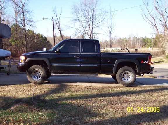

I was just wondering if anyone could tell what kind of lift set up this truck has, it said that it had a 2 inch lift but i was wondering what all he might have done to it lift wise to get a 2 inch lift? I would appreciate any comments, Thank you.
I uploaded the pictures but im not sure how you see them.

Probably cranked the torsion bars and stuck in a block in the rear. You don't have to get to scientific to get 2 inches of lift.
I agree with Jim...torsion bar crank and blocks in the rear.
big 10-4 by the looks of it
looks like a 2in body lift to me you can see the ex man in the pics.
Nope, you can see in this picture that there's no gap between the bed and frame.
PLUS the frame would be showing under the truck. A big tip off on BL trucks.

Hard to tell but in the first pic it looks like the front bumper has some spacers or washers or something in it to push it out a little further (extra clearance). I know some folks did this a while back ago on another forum on the 2500 and 3500s to fit bigger tires.
Can't tell if he has done this or not - but those look like pretty big tires for a 2" lift or torsion bar crank.
