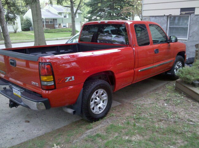

Hey guys, wanted to introduce myself and share my story.
I just got this 2005 Sierra z-71 on Monday. I loved the first 5 hours with my new truck, then my ABS light comes on and took it to my shop.

Nice truck, I love the color!

Sweet....now it's time for more pics. That's a great looking truck....course I am very partial to the wheels! :thumbs:
