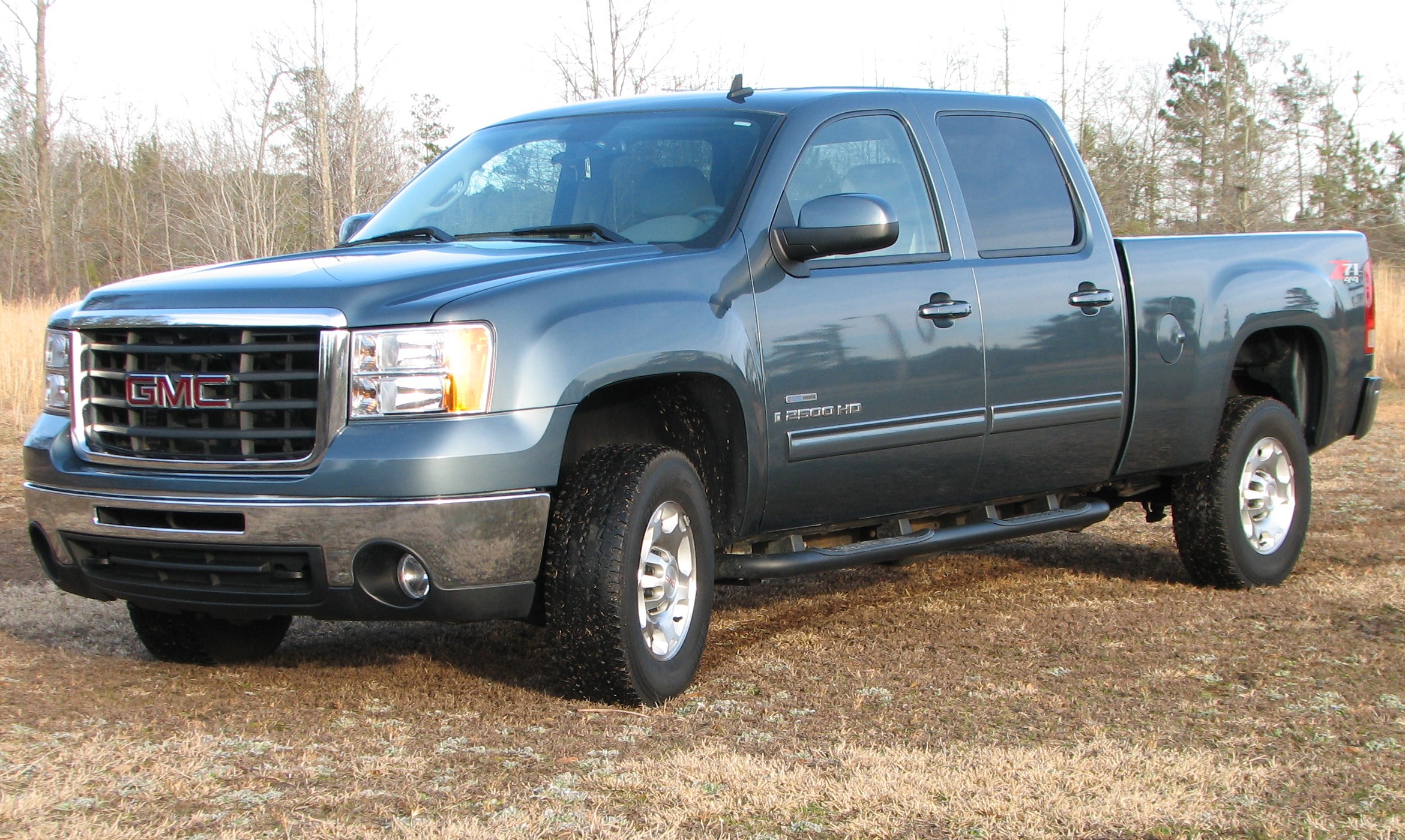

I love it! My truck is finally starting to look the way I want it to!
Details:
295/70R17 E
Torsion cranked
Alignment
65 psi
Factory 17x7.5 rims (N89)
Before
After
I want to get some 285-70R17's and was wondering if they would fit without to much trouble? Just a torsion crank should do it correct?

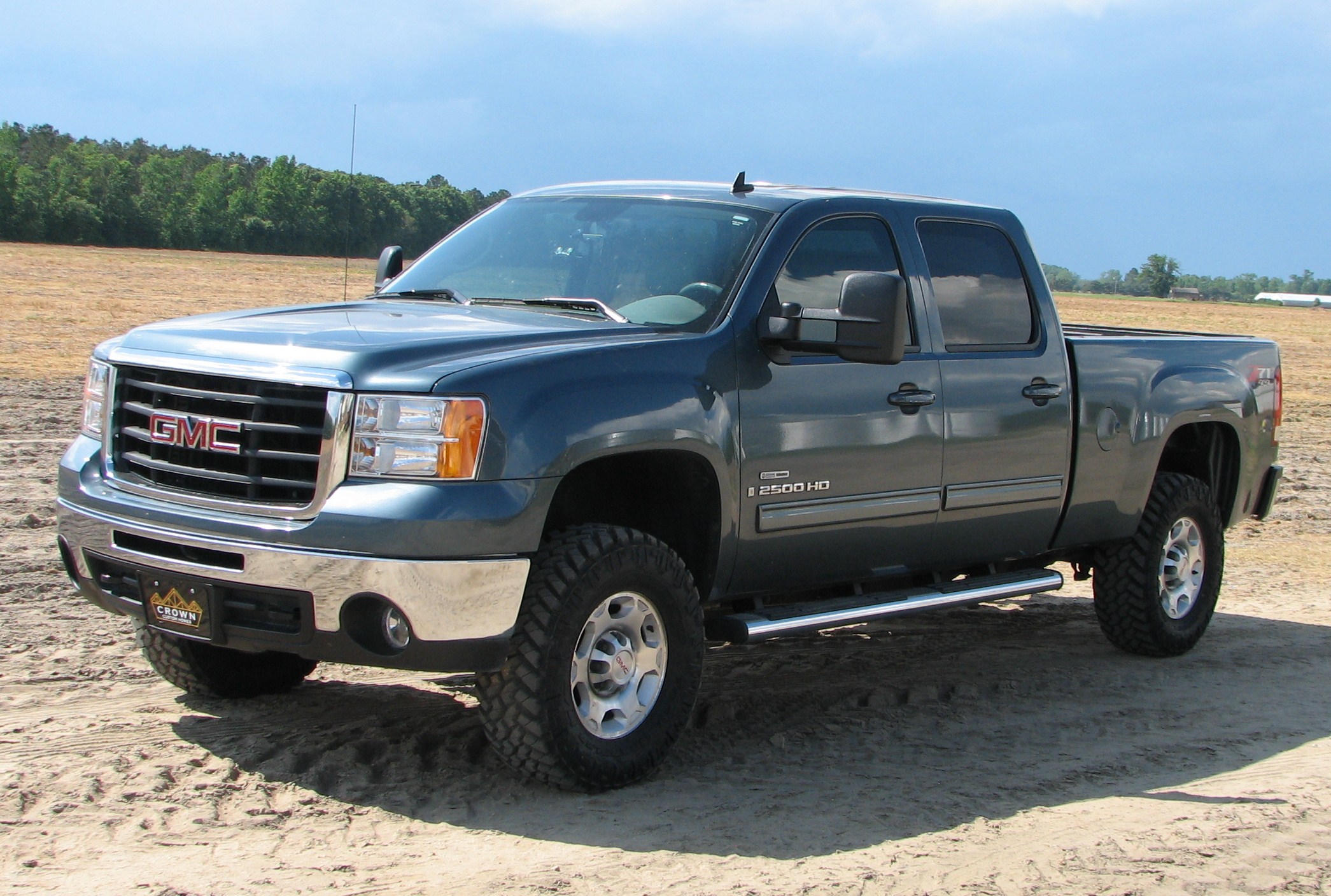

HUGE difference in look and stance! They look great on your truck!!! :thumbs:
Lookin' good Mark!! :thumbs:
It'll look good sitting on the property on Lake Norman when your building my house :P You know,The one I can't afford 'cause I ain't hit the lottery yet? :eek:
Thanks guys!
All I did was adjust the torsion bars, and use black tie wraps to tie back the wheel well liner where the "nubbys" rubbed at full lock. This is on a 2500 though, not sure of clearance on 1500. BTW, the step up to the step bars is noticeable. I'll try and measure tomorrow.
