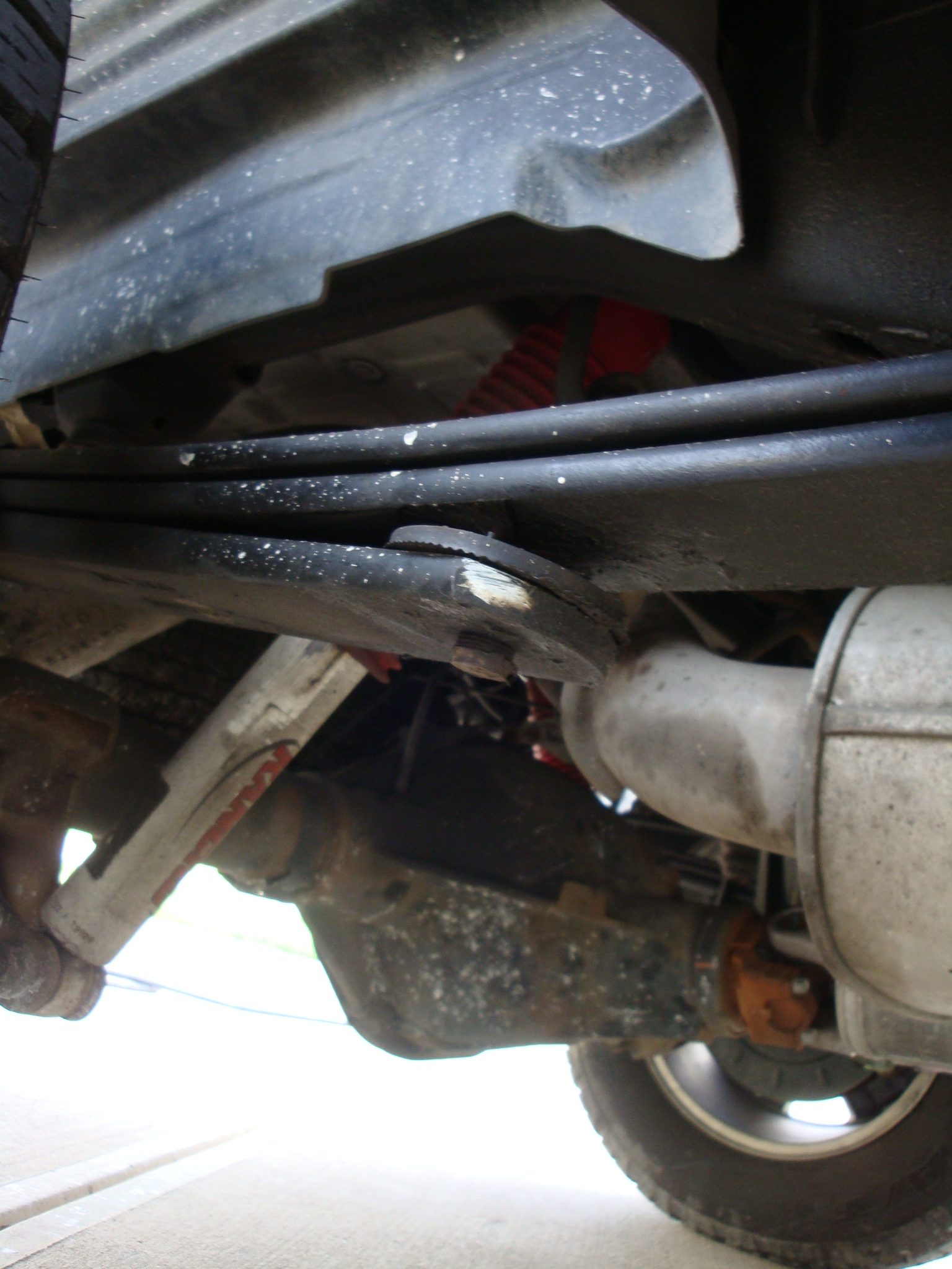

Well they installed them today. So far so good. Sounds much more solid, no noises whatsoever. I must say just looking and comparing my old springs to the new ones it seems like my old ones were more compressed than the new ones. I still have my theory of noise due to the truck being starpped down to tight to the train/truck. We will see how these hold up. I hope for more than 5K miles :lol:

So I'm not the only one that thinks only 3 leafs look rather weak under the truck? I'm in the process of putting new leafs in
Here s my theory. I THINK that the bushings on the front and rear mount of the leaf springs are the issues and maybe they are pressed into the spring (that s why they ordered the whole springs). A bad batch of bushings????
I agree that they are weak packs. I have an AAL in mine and it still sags pretty bad. I am locating some 2500 packs now.
