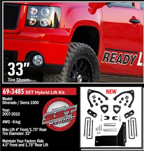

If not then Ready lift makes a 4" mild lift...a bit pricey though..

PS: That 4' readylift is junk, especially for the price. It's a glorified spacer lift that does nothing for tie-rod and lower balljoint angles. I feel bad for any poor sap that buys that kit... the cost to replace the steering rack when the seals blow out would make up the difference in cost between that "spacer lift" and a real lift kit.
