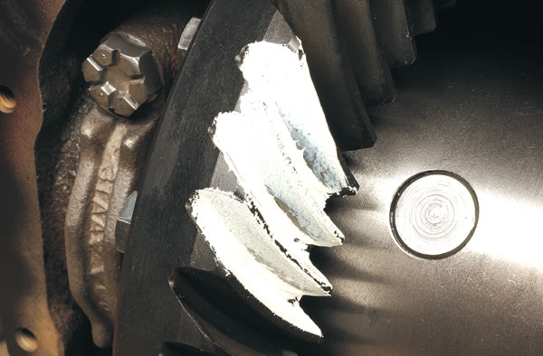

My experience with gears is that if they are noisy right away, they will only get worse. The two times I recall setting up gears myself, noise indicates that the mesh pattern is not right. If the mechanic is honest and agrees that there is excess noise, pulling the cover and checking the engagement pattern is a quick way to tell if the gears are setup properly.
The links below have some examples of proper engagement patterns. Simple white lithium grease will work for testing pattern. Other materials like white paints and similar work too.
Make the mechanic pull the cover and check the pattern and show you.

The following are examples of an improper pattern. Note how the pattern is not centered on the flank of the teeth. Patterns either inboard or outboard on the flank of the teeth mean the pinion depth and/or backlash is improper, usually pinion depth.
http://static.summitracing.com/global/imag...o02-must_17.jpg
http://www.dippy.org/svcman/image/0335.jpg
http://www.fnc.ch/images/content/technik/GEARS.jpg
http://farm4.static.flickr.com/3049/305421..._b95121c907.jpg
The lash between the gears is not adjusted properly. Tell them to correct it.
Could be...or also could be pinion depth. Very often, it's the pinion depth that is improper. This is because backlash is easier to change and set in most axles.

As everyone else is saying the gears are not meshing and/or there is too much lash. Personally I would not touch it unless you were the one to put it in. If you had a shop do it, bring it back to them and tell them to fix it. The whining noise is caused when there is to much lash between the ring and pinion gears, caused by not shimming it correctly. You also want to make sure that they test to see where the gears are making contact, ideally you want the pinion to be mated dead center on the ring gears tooth, deeper in will bind and where quickly and on the outer will break a tooth or teeth on the ring gear when put under a load.
The whine will not hurt the gears it will just be annoying, it is the contact pattern that is the real killer
