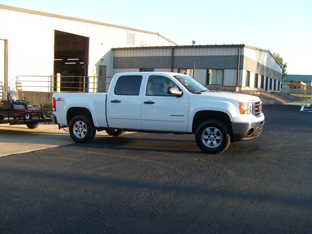

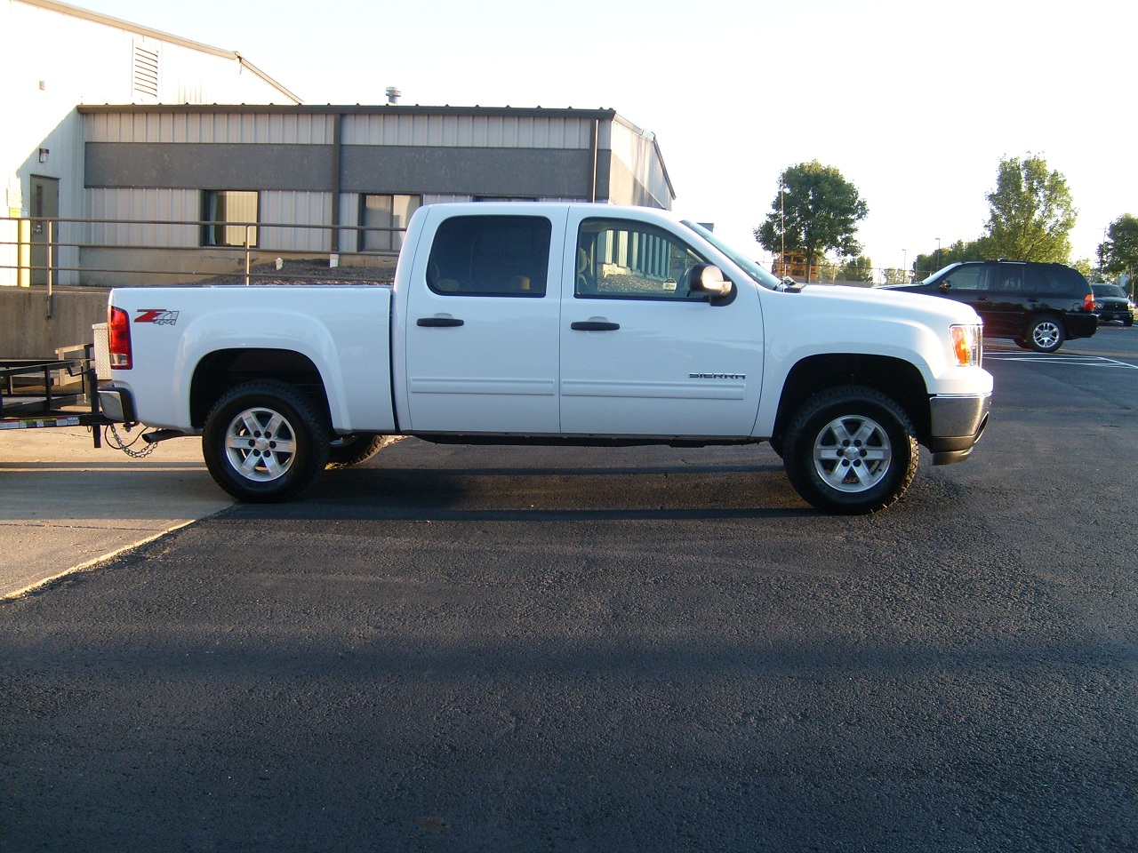

Installed 2inch Rc Leveling Kit And 2.5 Rear Blocks
Installed 2 inch leveling kit and 2.5 rear Block. These pictures are not that great. Everything went together good. Took me about 2 hours by myself to do the front and back. I am happy with it and get it aligned after work today. The ride feels the same.
I Just got my alignment done and everything went good. I was worried about the back but everything came out good. I Don't notice a difference in the ride. I read on here someone talking about a vibration in 4wd around 60mph so I tried it out and I did not get any vibration. Everything is good so far so I hope it stays that way.
i only did it if i got on the gas and accelerate. Its a light rumble feeling. No need to be in 4x4 at that speed anyways. It didn't do it just cursing one speed

I understand you adding a '2 leveling kit in the front, but won't adding the 2.5 block in the rear unlevel your truck?
Yeah I wanted to keep some rake in the truck for when I am hauling anything heavy. I leveled out my last truck and i ended up adding a leaf to raise the back up a inch so it would not sag so I decided to do it all at once this time.

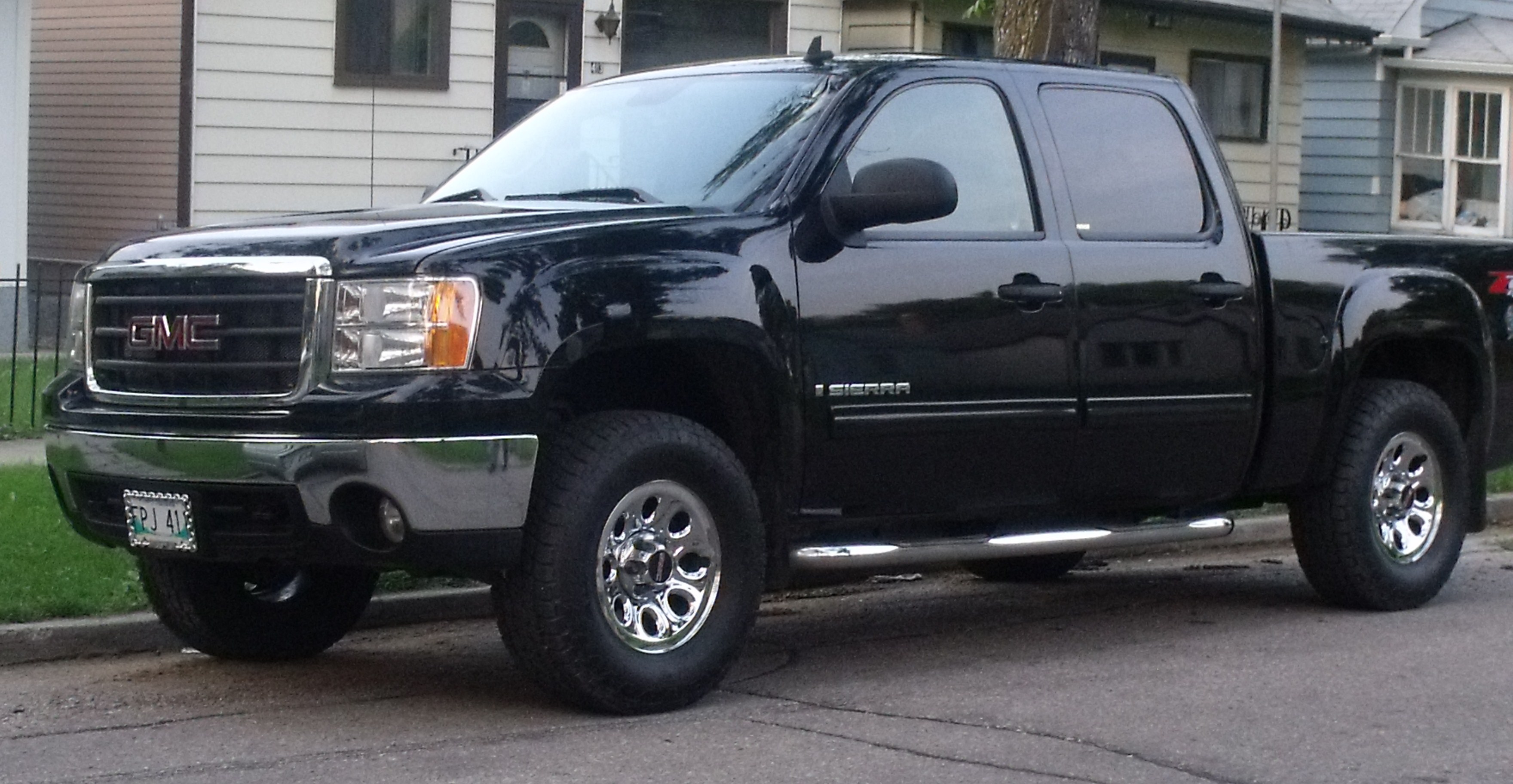

This is my 07 with 2 inch RC level kit 295/70/17
Not sure now if a 2 inch Body lift or a 3 inch susp lift is in order

I did the same thing....when I installed my 1 1/2" front leveling kit the front looked a'little higher than the rear,so I installed 1" rear lift blocks and it brought it up perfect with just the right amount of rake.
