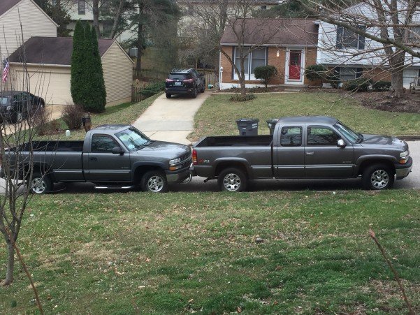

Interesting topic.  I have two 2002 Silverado's.  My work truck has a 5.3 and a 4L60E two wheel drive transmission with 215,000 miles.  It has had no transmission trouble at all since new.  I have serviced it twice, once at around 100k, then again at 200k.  I have been extremely rough on it, hauling/towing exc.  My other one is a 2002 LT 5.3 Z71 4L60E 4WD.  I have driven this one easy and I had to have the transmission rebuilt at 108,000.  The sunshell went out and I lost second, fourth and reverse.  My repair guy said sometimes you just get a bad one, no rhyme or reason to it.  There are no known bad years or serial numbers that you can track to see if you are going to win the rebuild lottery.  The rebuild was relatively inexpensive compared to other transmissions ($2300) out the door.  He said he used updated stronger parts than new and that he has never had one come back, so I figured it was worth it.
