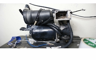

1- Open solenoid (External - you can resolder the lead as explained in the above link) picture -1

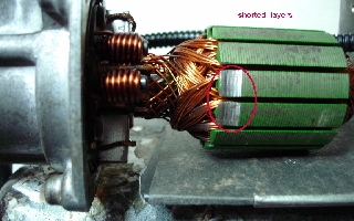

4- scratched metal layers of the rotor core due to the friction with the stator magnets : the rust particules are like powder and when the rotor is rotating these particules are
coming between the core and the magnets and cause a strong etching of the stator) pic-4 and pic-5 / this case is "not repairable"

I have a 2005 cadillac escalade and on the 70000 km i noticed "service ride control message" on the dashboard.
i have pulled the compressor assy and applied 12v dc to the exhaust solenoid but it did not click.
I have tested the coil by the multitester (it should read 21 or 22 Ohms) and found it open.
Unscrewed the 2 screws of the coil housing ,the canister was plenty of corrosion and salt residus .
the full solenoid assy was jammed and strongly corroded pic-6
I have dimenteled it and soak it in WD-40 for 1 day .
in parallel i ahve removed the tape which is surrounding the coil and found that both leads are well soldered and intact although there is plenty of rust.
i have desoldered the 2 leads of the coil and start unrolling out the copper wire to find the internal cut.(the coil length is 77.5 Meters - the copper wire gauge is : 28 .
after unrolling half of the bobbin i have found the "cut" pic-7 - i have encountered many cases like that .
i have decided to rewind it manually with a lot of patience by making a home made coil rewinder ,using a battery operated screw driver and a stand for a drill (pic-9)
i bought a 100 meters of 28 gauge copper wire and a bottle of varnish ,measured a 77.5 meters of copper wire and started winding the coil and applying varnish between layers
till it is done (it took 2 hours to finish it)
i kept the assy under the bulb to let the varnish harden under heat so the coil will dissipate easily the heat whenever it is triggered by the car system.
pull out the tiny white cloth filter and clean it -pic-9
have resoldered the blue and white wires and assembled the housing and shaft and sealed the canister with silicone sealant.
now the solenoid is ready to work.

The seized water in the crank case is causing the crank to get jammed especially if you keep the car without usage for a period of time where the water will start creating rust
and cause the crank to get jammed.(soak it in WD-40 for 1 day and clean it thoroughly alongwith the rotor housing - pic-5)
