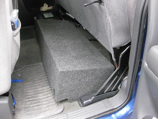

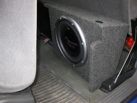

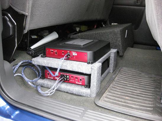

I have also recently installed a stereo system in my ’04. This was the second time, the first aftermarket setup having been stolen from me about a month ago. I did not have the Bose factory system, but it looks like the adapter you picked out will take care of connecting that equipment for you. I did opt for the steering wheel control adapter. As far as I’m concerned, this is a must-have. I went without for a month or so and missed them dearly. I went with the Pioneer DEH-4200UB. This head unit is dirt cheap now, but it has excellent features. Like the one mike has, it has the usb control for the ipod and sounds fantastic. It also has 3 lines of text on the display so for example, you can see artist, track, and album info. You did not mention if you had extended or regular cab. There are some really nice boxes available that fit right under the back seat if you have extended cab. I’ll attach a picture of what I installed.
