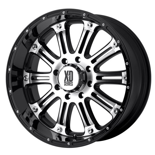

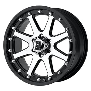

Here are some for your consideration. (Keeping with the XD black/machined look).
20x9 XD Hoss (+18mm Offset / 5.71" Backspacing)
20x9 XD Addict (+18mm Offset / 5.71" Backspacing)
The black/machined Hoss looks gooood. IMO
I like the Hoss Machined... Good sub for the diesel since they do not make what i need. :nonod:
