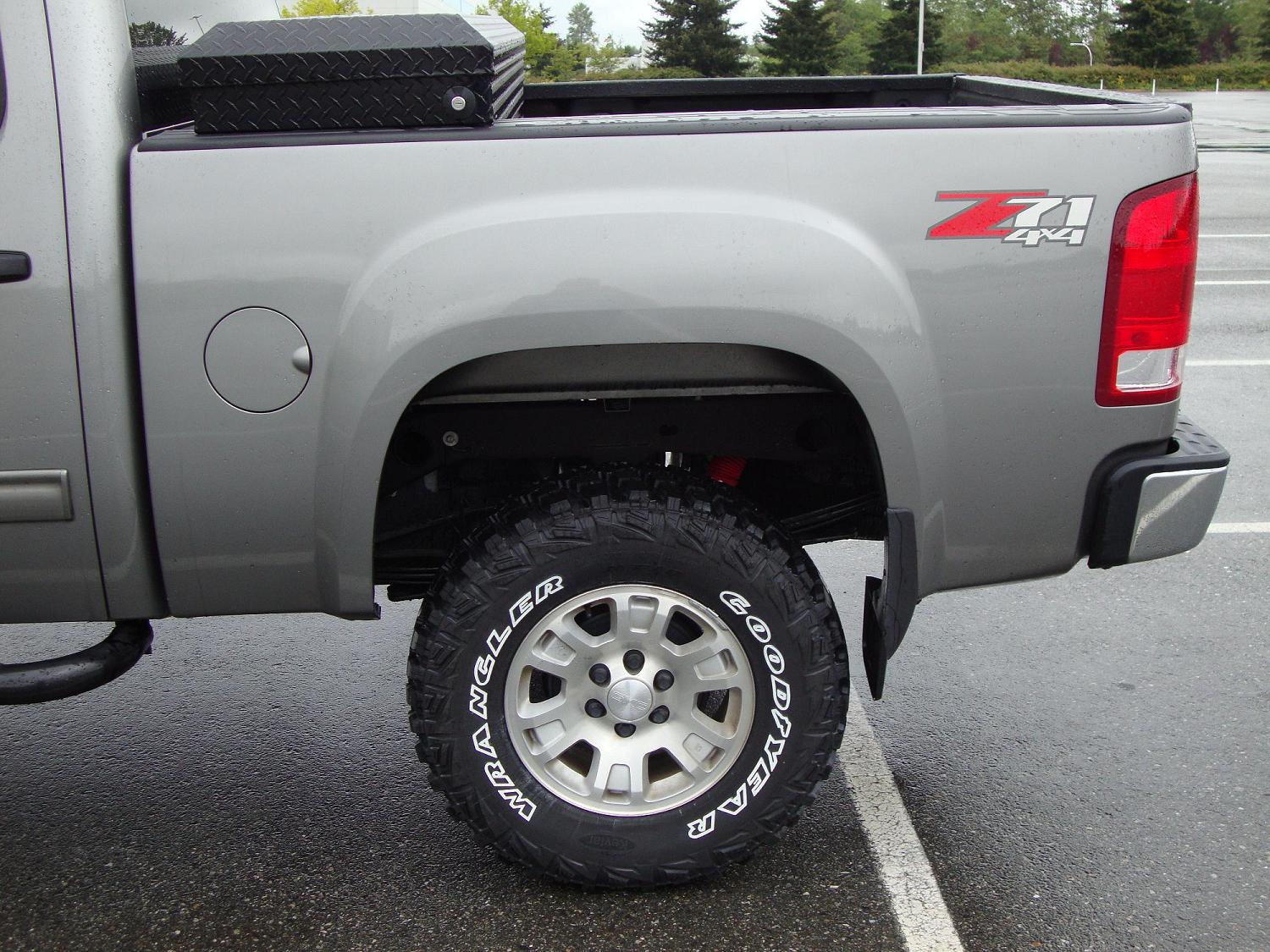

When I started all this I got the 2" level and thought I was happy. Then I got some bigger tires 275/70/18 BFG's and again thought I was happy. Then I started to think about possibly getting a suspension lift. I was convinced I only wanted a 4" lift and 33x12.5 tires. Then I saw where the BDS 4 and 6 lift were the same price (I think they're $12 difference) so I got to thinking why not get the 6" for the same price cause install was going to be the same either way. Anyway I think the BDS site was showing the 6" lift for 2200 (its 1813 today) I did some web searching and found I could get the BDS 6" with gas shocks and stainless brake lines for 1599.99 from All Terrain Fabrications so I called them up and decided that was the way I would go and placed the order. Got the kit, went through some BS with the install shop but finally got it installed. I was under the impression I wasnt going to be able to use my stock wheels so I ordered some 18x9 with 4.75 back space. But my stock wheels worked fine with the 33x11 I was runnig. I was going to just run the 33" tires I had and it looked fine even with my 33's only being 11" wide but I saw a GMT 900 with some 35's and said I had to have them :lol:
I had to cut some plastic and knock the rear of the front fender back a little for the 35's. I then decided to get a 1.5 zone body lift and now I wish I would have gone ahead and gotten the 3" body lift.
6" with 33x11 tires stock wheels
6" 33x11 18x9 wheels (ignore the white letters out; didn't know what I was thinking)
6" with 35's no body lift yet
added 1.5 bl
