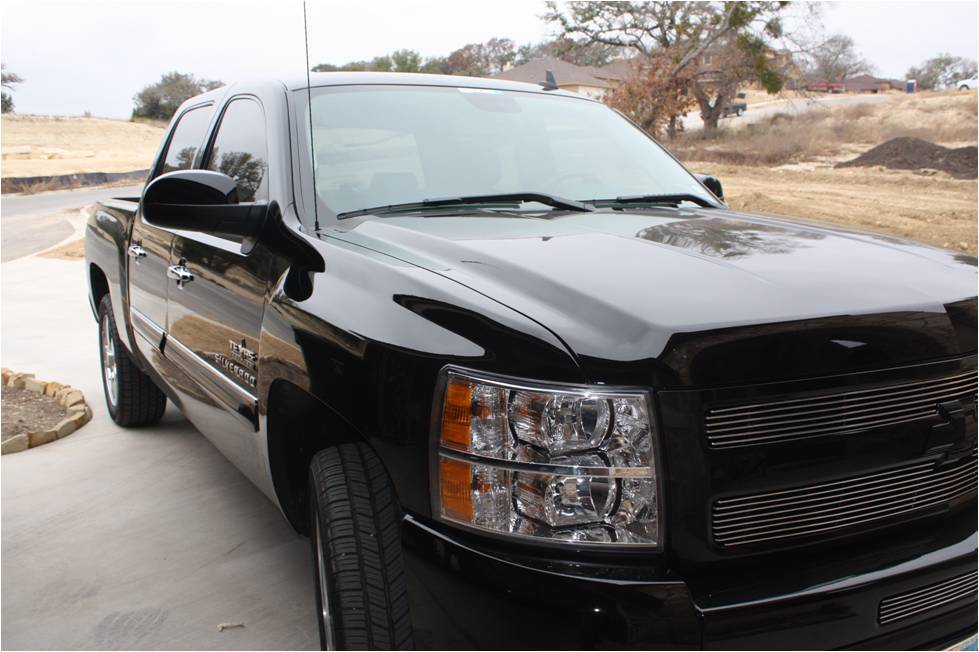

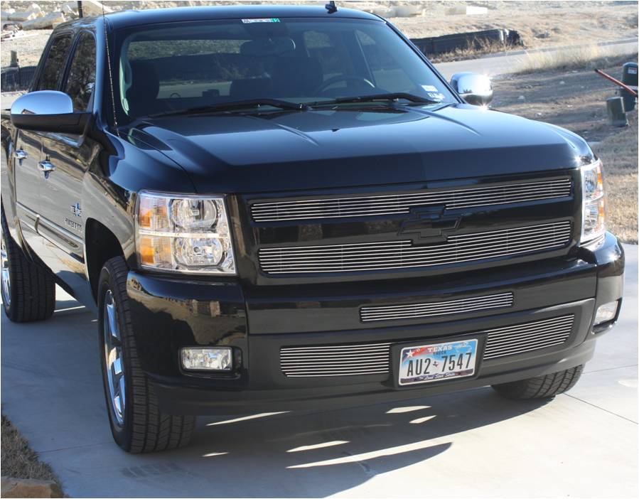

I much prefer the painted covers. I also prefer painted door handles as well. Too bad GM does not sell the door handles painted, they are all listed as being paint to match.
I still have my chrome handles and mirror caps. I don't want to sell them because when I ever get rid of the truck I will have all stock pieces. If I need or someone else wants to change it back. I don't like much chrome thats why I had to change the front, mirrors and handles. I had to change my truck when i walked up to another and the remote wouldn't unlock the door. Since i did all the changes I get more complements and how-tos to change their truck.
