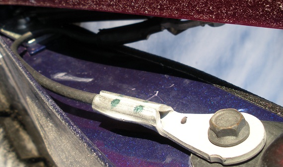

Looks like I got the wrong one sent to me. Got a new one in the mail from company and works like a charm. You can see obvious differences like the way it mounts and the size. Take a look.
This was the first one
This was the correct one

The concern was raised in a post above about the cable getting mashed or kinked. I remember mine kinked once right after I put this on, I straightened it out and kept an eye on it. Never noticed it happening again. Not sure why, I did not do anything to keep it from happening. It has been 8+ months and, IMO, everything on that side of the tail gate looks healthy still.
Here are some pictures. Road salt included for free.
That was the same wrong one I got. Would not slow the tailgate down at all. Went back to Truck World, and the next package was the correct one.
Same here. Had to "fix" it so the cable didn't get kinked or stick out, a few times. I kinda thought that was gonna bug me. However, it quit doing it, as if it learned the right way to fold.
