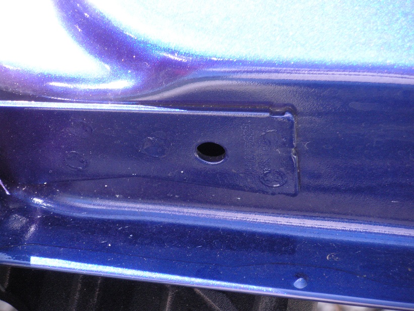

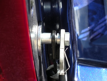

Drove by an O'Reilly's I did not know was there so I stopped and picked this little critter out. The package said it would fit 2007 and up, not just 2007-2010 like it says on the website for this product. Thanks for the pictures and info from DaveH71, AntelopeZ71, and others. I can add that this fits fine on my 2011 as well. I did not have to cut my washer down; my side bolt is apparently further away from the weld seam so the washer sits flat. Another 0.5mm further in and I would have had to trim the washer, or use another one. I probably should have used another one anyway as the washer in my kit is plain zinc coated steel.
The only tools I used were 10 & 13mm wrenches and 4 & 5mm Allen wrenches.

The washer would have contacted the bend, so I just got a slightly smaller washer that fit. The only concern I have is that the new, longer tailgate support (where the EZdown attaches at the top), deflects somewhat when I sit on the tailgate in the down position. Also, the hex flat head screw that goes into the collared bolt doesn't feel really secure, and loosens up after wiggling the new lower mounting point. I'm afraid to tighten up that collared bolt any more, but don't know how to deal with the loosening of the entire lower apparatus...
