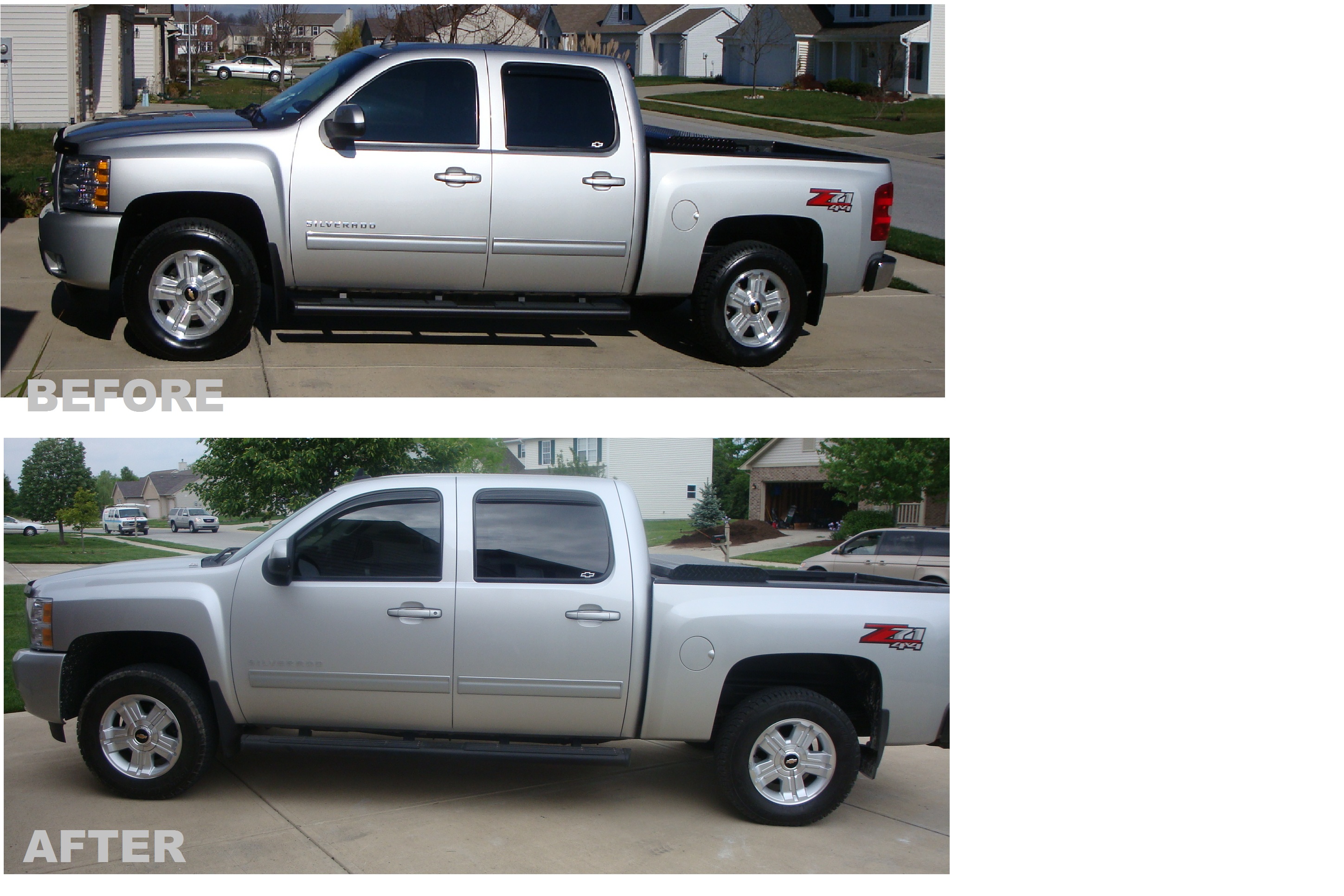

thinking about going to a local spring shop and adding a leaf, i want to get some height back in the rear. After installing a BDS leveling kit in the front the rear also sags when loaded. I haul alot of dirt/mulch in the summer might as well benifit from both the height and the payload..

added a BDS 2" leveling kit for larger tires however when I loaded junk in the bed the rear sagged. Thought about blocks even ordered them. I deceided to send them back and add a leaf.
$318 at a local spring shop, raised the rear from 39" to 41"
The ride did not suffer at all - I hit every bump I could find on the way home.
All those post of "your ride is going to suffer" "it will change the factory ride"
bla bla bla
glad I didn't listen to those comments. I am glad I made up my own mind. Couldn't be happier with the results.
No wories of block failuer, axel wrapping...
before and after pcis
Stock
After Level Kit and spring
