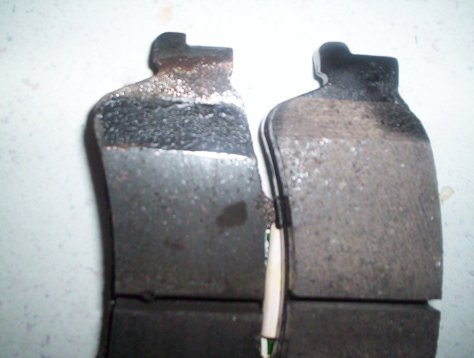

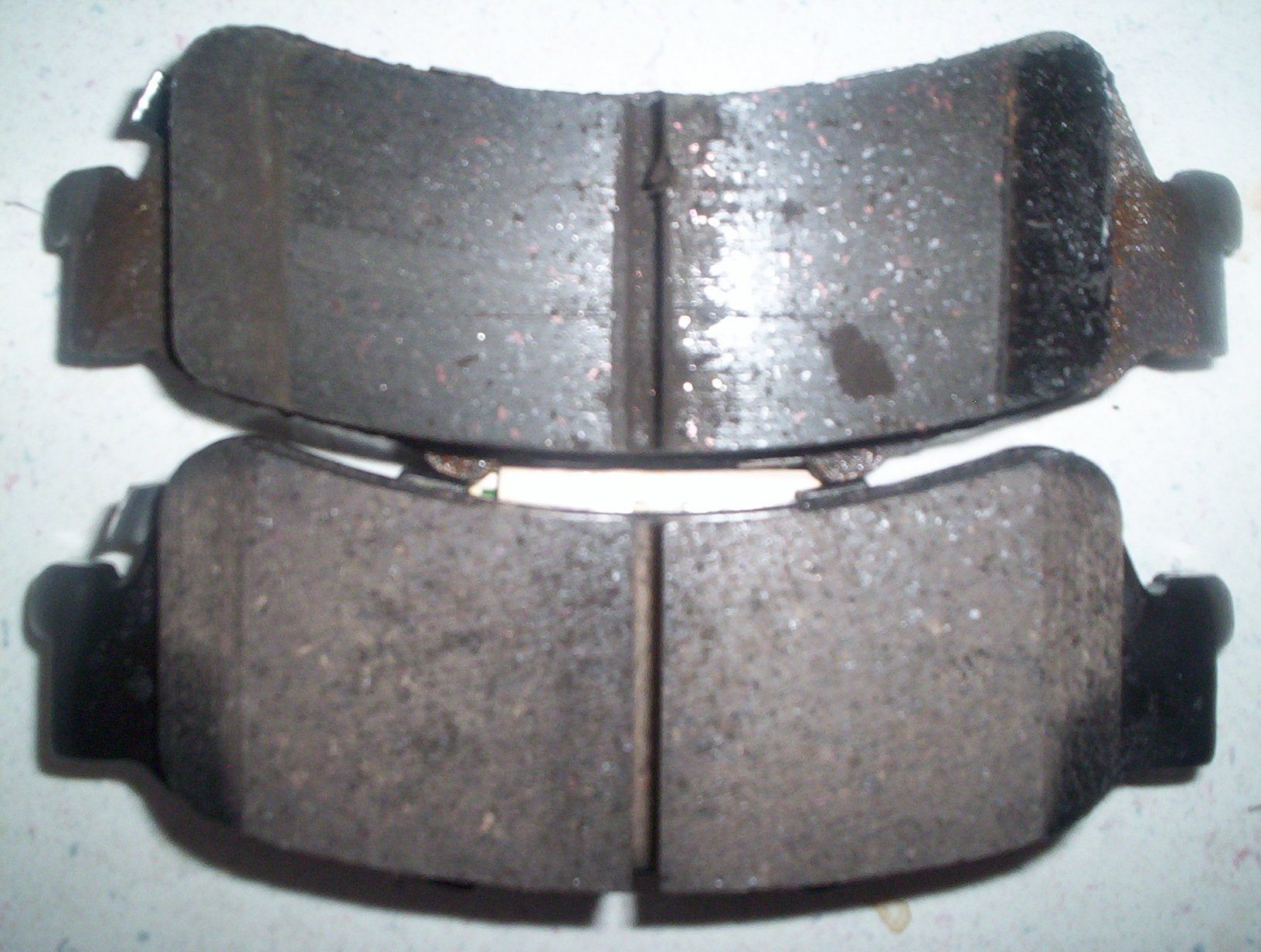

Okay, well, this problem is solved. Installed OEM GM pads for the rear-end. Brakes feeling good again, stops with less pedal pressure. Folks, this may be hard to believe, but there really is a difference. If you buy brake pads for your truck I would strongly recommend going with the OEM pads. Not ACDelco Durastops, but the real deal. Yes, you'll have to pay more, but you'll get the stopping power your truck was born with. Just don't buy them at the dealer, they'll rape you. They wanted 180 bucks near me! I got them from an ACDelco retailer for $96.00. I had trouble believing that REAR pads could make this noticable of a difference, but they do. Attached are some pictures that show the difference between the two pads. The only real thing I can see is about 3/4 of a square inch less surface area (the CQ pads are angled more gradually, making for a smaller initial contact area. Take a look at the pics below, you'll see what I mean. OEM pad is on the bottom in top pick, on the right in bottom. I'll continue to be a Carquest customer though because their service is excellent. They let me return the pads and gave me a full refund.
The pads have a bigger chamfer to help reduce noise. Making pads that stop quick, last forever and are whusoer quiet is tuff job. Something always has to be sacrificed...
