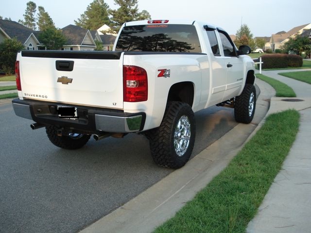

Very nice. I'd like more lift in the back, if it were mine, but that's just me.

I think it is level...I mean it is the fabtech lift....I def don't want any cali lean.......now you're going to make me go look at it.

From what I've found, over the years of installing ifs lift kits, most will initially set the front higher or perfectly level (when measured on level surface) where as I prefer a truck to have a bit of positive rake (rear higher) still to it after a suspension modification. My current truck, sits nearly perfectly level as measured so it will most likely get a set of 2" blocks for the rear to bring the rear up a smidge more than it is currently. It's all a matter of opinion, really, that's all.

I just went out and measured from the top of the tire to the fender....the front is 1.5 inches higher.....I hadn't noticed it. How can I make the rear slightly higher? Can I just add another 2" block?
Add-a-leaf, different leaf springs, taller block or any combination of those three.
I am NOT a fan of stacking blocks. Bad things can happen when you stack blocks.

Def. stacking blocks is a no no.. You can how ever purchase taller blocks :thumbs:

cant do add a leaf the fabtech already uses it. You can do a bigger block or a lift shackle in the back. Other options would be shackle flip or spring pack in the back.
My fabtech didnt have 1.5" of cali lean but more like .5 or so. I added a 1.5" front spacer and a 2" rear lift shackle and now its dead flat.
Unless the installer failed to put the AAL in. I've seen this several times. Op, you shouldn't have that much cali with that kit. I know a couple of guys with the same setup and theirs is level.
