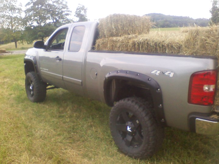

bs is 4.5 inches....the tech at Fabtech said it would work...don't realy want to go down that road again. I DO think it looks GREAT, if I can get the tires to clear with a leveling kit.
I posted pics on like page 2 or 3....fyi

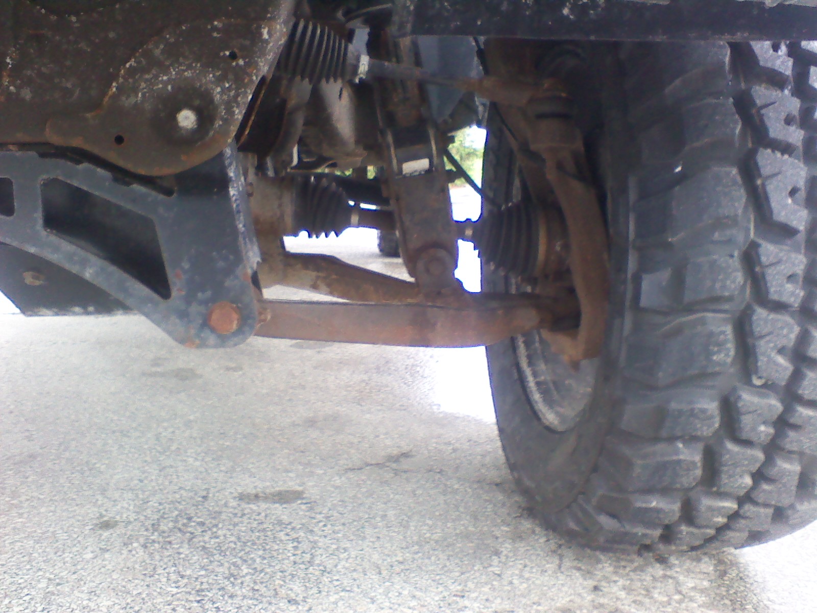

attached the only pics i have and they are all from my old shitty cellphone so I apologize. I got one in there that shows u the angles with the spacer in there. The nice thing about the fabtech is its a full diff drop so you can get away with the level kit and still have purdy angles
EDIT: Please excuse the nastiness off the lower control arms and underside of my truck. I have since crawled under there with a pressure washer and brush and scrubbed the entire thing clean and repainted it, and it looks like new again. In those pics it looks all rusty but its this brown crap they spray on the ground in the steel mills that coats the entire underside of your truck and needs scrubbed off.
OHHH and one more thing. That dude at the shop has to be blind.. Not only did he not see the bullshit coil spacer thing u had, but he also perceived the BDS kit as taller? theres no way. Ur setup has to be like minimum 2-2.5"s taller with that autozone spacer in there.
