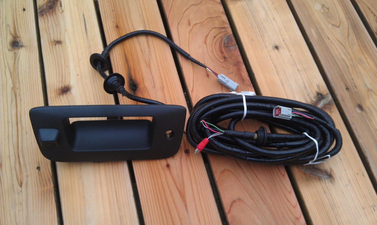

Here's the OE tailgate camera kit that we use (this shows the universal version, but the OE navi version terminates the gray/blue and gray/red in pins that insert into the factory plug):
The kit requires you to remove the tailgate and drill a 29mm hole in the tailgate AND the bed (you could use the existing large hole in the bed, but it's got a rolled edge and will not grip the supplied grommet). It comes with paper templates and factory-style instructions - (honestly, they're a little more in-depth than I need, but if it's your first time, they're VERY thorough...)
