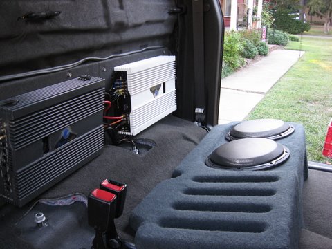

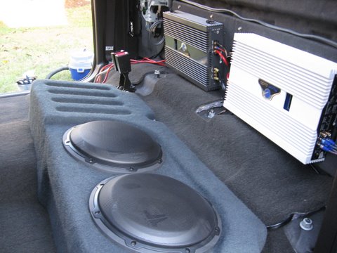

I put 2 rather large amps on the back wall of my 2008 ex-cab.
here is a few pics
That looks really great, but once you put the seat back on will it fold up? When checking things out in my truck I noticed that when the rear seat is down there is room behind it, then when you fold it up it sits flush.
here is a few pics
The seat will fold up a little on driver side, but no real need to lift any higher with the stealthbox there. I have full lift on the passenger side seat. Alot of planning and test fitting went into installing those two amps. Had to do some fab work to make them fit and no longer have a center seat belt.
