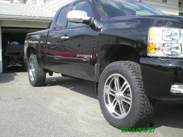

Hey Fuzzy, I have the RC 2' level with the RC 1.25" body lift running on 275/60/20 Coopers (33x11?) and every once in while I will get slight rubbing on the passenger side while turning left and hitting a bump.
some pics
