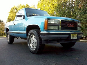

Hey everybody, I have been having trouble starting my 93 gmc sierra 1500 350 5 speed truck, The truck seems to follow a pattern of when it won't start, It will start fine when it has not been used in a few days, however if I were to shut the engine off while its at operating temperature there is about a 40% chance that the truck will start up again. When the truck doesn't start there is no sputtering or anything, the starter motor just spins without hope so I have been using small amounts of starting fluid to get it going. Here is a list of things that I have changed in the past 30 days (starter, spark plugs, wires, distributor cap and rotor, ignition coil ).
