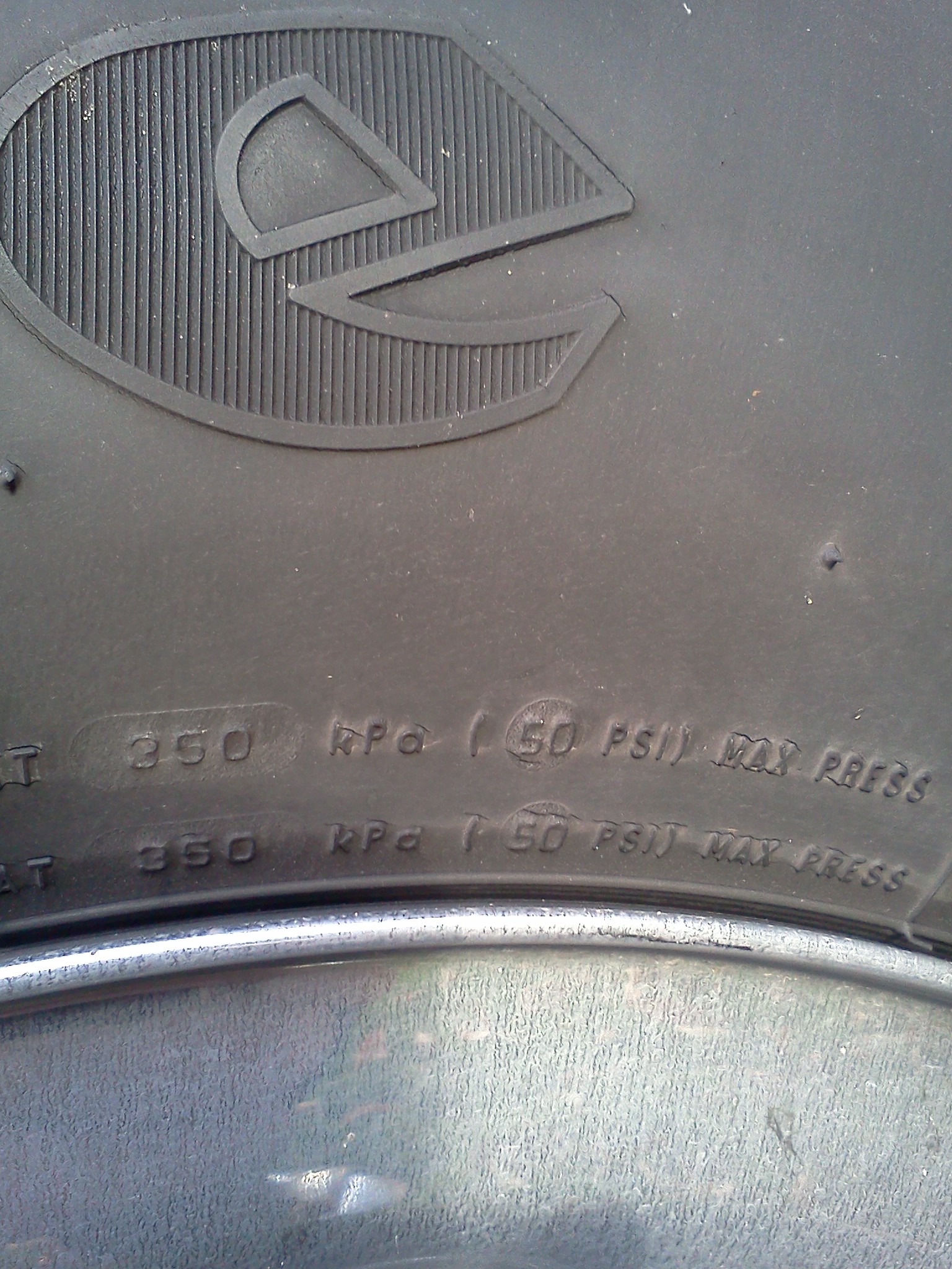

Good day....I have a 2009 GMC Sierra Nevada Edition Quad Cab....This edition of truck is widley sold in Canada....It has a 4.8L with a 4 speed automatic trans......my truck new I would be lucky to get 380 kms per tank.....now at 40, 000km I can get over 520kms per tank. The truck has only had a slight oil leak between the engine and the oil filter adaptor port....In the Niagara Region, there is an alignment shop called Ace alignment....these guys are so good that they can catch factory defects....I would suggest to take your truck to the best alignment shop in your region and have a full alignment check.....tire pressure (on the factory tires) should be 50lbs psi....I find that these trucks do lag in first gear with a `soft foot`. Ethanol enhaced gas can burn quicker.....

50 lbs on stock tires? :)
50 PSI? where the hell did you pull that number from.. the proper COLD pressure for FACTORY tires is whatever is stamped on the plaque located in the drivers side door jam.
mine says 32 psi cold for the 275/55R20s. and the 2008 GMC Sierra 1500 SLE parked next to my vehicle with the 265/70R17s says 35 psi..
The only tires that are inflated to 50+ psi would be LT series on 2500 HD trucks and up.

Strange.......What kind / brand of tires came on that truck?

Firestone Transforce AT LT245/70R17.....Most "Nevada Edition" trucks sold here in Canada came with these tires....

that says 45psi not 50psi.. but I doubt 5 psi is going to have a major affect on the tire wear, the psi will fluctuate more than that during normal driving.
curious though that the Canadian spec is 10 pounds higher than the U.S. spec.
