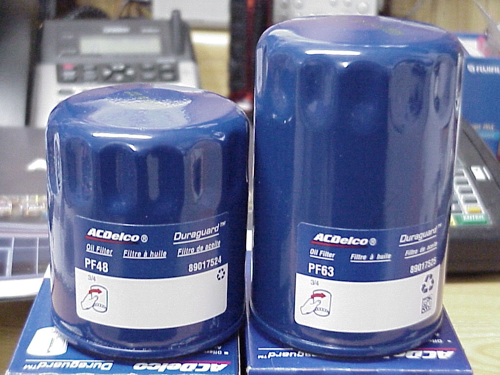

People have been doing this for years....... It is even listed in the back of the WIX filter catalog for most filters. Note, during an engine transplant that moves your filter into the wrong location, this is the section that becomes your best friend. .. ...
The 350's had a 1060 in 2wd form and 1036 in 4wd form. You could on a 2wd place a 1794 filter in its spot, it is a 2 quart filter instead of 1 quart as the 1060 had.
Now, with that said, if your in warranty, play buy the GM rules. PF what ever they say or its equivalant in another brand (Magnuson-Moss Act, Tie-in-Sales). But if your out of warranty feel free to add the larger filter and extra capacity.
The extra capacity could bring your engine oil temp down a little (especially with an oil cooler), as you now have more oil in the system. Therefor adding more oil to be circulated around in the system. If your thinking that way. Edgewise, the add oil in the oil filter, could result in more oil to the top of the block quicker after starting the engine. Or, the extra oil could be a plus if you poked a hole in your filter, or oil pan.

From all that I have read the filter characteristics appear to be the same (relief and anti drainback valves). And there are a number of new GM models that come with the PF63 that say replace with the PF48. So they both have the same threads. This topic has been discussed before around the net. I will be changing to a PF63 with my next oil change.
http://www.gm-trucks...howtopic=119855
Did some more checking and found the specs:
PF63
Product Type Full-Flow Lube Spin-on
Anti-Drain Valve YES
Gasket I.D. 2.45"
Gasket O.D. 2.76"
Gasket Usage Base
Product Height 4.06"
Product I.D. 22mmx1.5mm Th'd
Product O.D. 2.98"
Relief Valve Setting PSI 9-15
PF48
Gasket I.D. 2.45"
Gasket O.D. 2.76"
Gasket Thickness .19"
Gasket Usage Base
Product Height 3.33"
Product O.D. 3"
Relief Valve Setting PSI 9-12
Seems like the only real specification difference is Pressure spring valve setting (9-12 PSI vs 9-15 PSI) IMO, not a real difference.

i've been running the longer filter on my fbody cars for years (many of us have). on the ls1 motors the longer filter does hand just below the pan... i understand the potential for disaster, but 4 ls1 cars in 14 years and i've yet to have a problem.
i'll be putting the longer filter on my truck next filter change - thank you!

Other way around on the 48/63 stuff. Any/all 2011 and up high feature V6 engines (3.0, 3.6 V6) can and may leave the factory with a 48, but the service filter is the 63. As far as I see, there was no reason given by GM for the filter switch but I think its due to timing chain stretch issues in the Lambda trucks (side note: Long oil change intervals and dino oil seems to be common amogst those issues with the chains). Bigger filter with more filtering media to pair up with the OLM and now the use of Dexos. GM does say that a 63 can go on pre 2011 high feature V6's, no problem.
GM has not said, however, if a 63 can be used on trucks, so personally, I wouldn't run one unless GM puts it on from the factory or if they say its doable.
Well, you can always buy the Wix filter cross reference. It's a whopping 4.8" tall. Go Big! :ughdance:
Ding, ding, ding! That is the bottom line folks. Yes the 48 and 63 have very similar specs but that argument isnt going to work in warranty land if you have any issues. You need to follow GM's spec on the filter to avoid any warranty problems and be aware you need to follow GM's spec. Not the dealer, not a gm mechanic but GM themselves.
I have talked about the advantages of a taller filter in one of my previous posts but the slight advantages are not worth the trouble it could cause if you are still under warranty.
