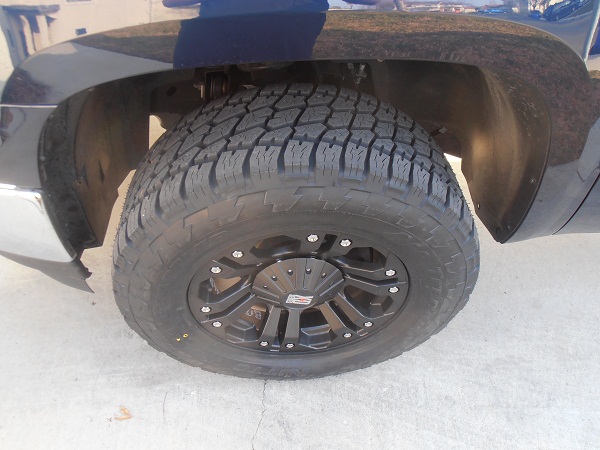

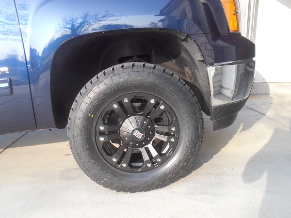

Yes they do fit just installed tonight 18 XD MONSTERS 305/60/18 NITTO TERRA GRAPPLERS fit but very minor trimming just the plastic inside the wheel well barely rubs when in full lock pics will be on tomorrow
i had to trim the plastics a little bit its all good now if u have a 2" or more kit u might be fine i have +18 offset and they rubbed just a tad though

heres the tires u should be fine with the 2.5 just curious how high is ur front end mine measured out at 38 3/4 after front alignment
the 305 are alot cheaper then the 285 but the 305 are a 3/4in wider and just a tad bit smaller but the 305 is a perfect match for this truck with the leveling kit
