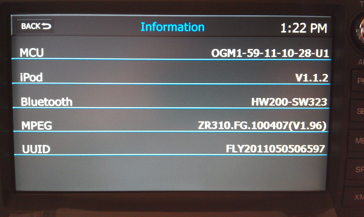

You can check the version installed in your deck by hitting "SETUP>INFO", then reading the top line "MCU" - It should look like this:
If it does NOT read "OGM1-59-11-10-28-U1", download the latest firmware at the link below.
