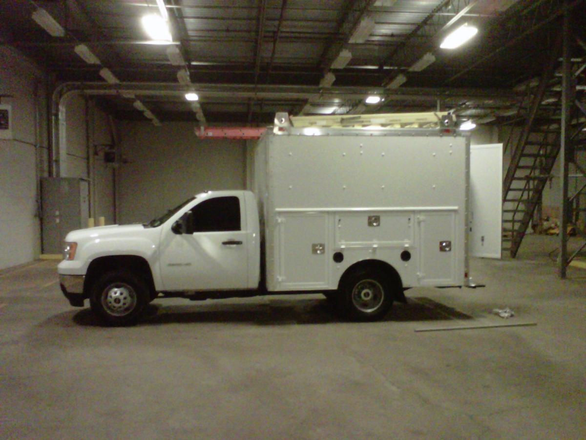

My 2011 3500 DRW work truck with tool box body is getting just over 10 mpg if I drive easy which I almost always do. I had the truck weighed at a local quarry and it comes in at 9867 lbs with pretty much all of my tools. I may have thrown some more in since then so I'd say 10,000 lbs.
Do any of you D-max guys have 10,000 lb loaded truck and if so what kind of mileage are you getting. Just curious what i could be getting if I get a diesel next time.
