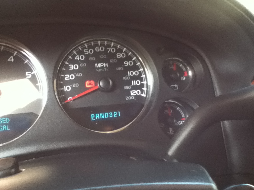

elite0259 Posted March 13, 2012 Posted March 13, 2012 OK so I did something stupid and left my radio on for 2-3 hours today while I washed/detailed my truck... Long story short the day ended with a jumper pack. Now the red battery light is on and a message saying to check the battery charging system, but the volt guage is reading over 14 with the truck running. Is the light just going to go away by itself? or did i really screw something up...
Morgan1986 Posted March 13, 2012 Posted March 13, 2012 Dont know try disconnecting the black battery cable to reset things and see if it goes away ?
Morgan1986 Posted March 13, 2012 Posted March 13, 2012 Thanks for the idea. It went away! Yays first time I helped someone on here lol .
