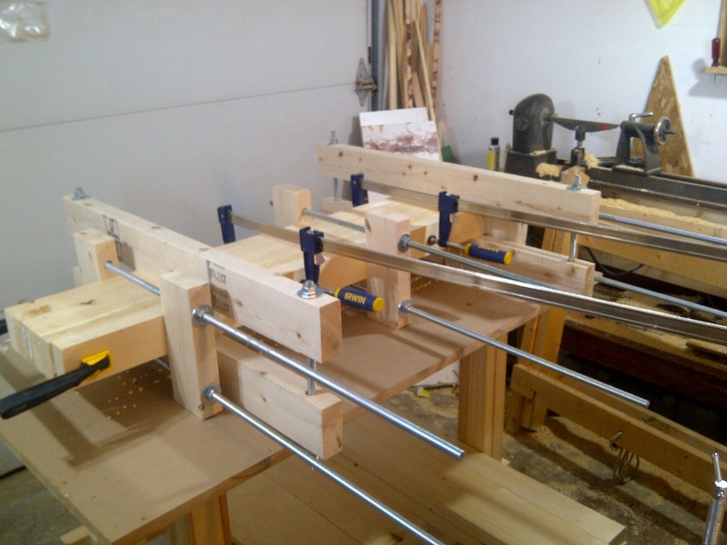

Gluing up the top:
I did the top in 3 sections, so I could fit them through the planer before gluing the 3 together.
Please excuse the hillbilly clamps, not everyone can afford Bessey's.

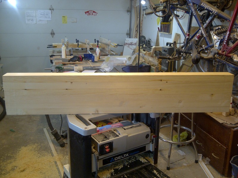

The first slab after running it through the planer:
The final thickness is around 2 5/8". Should be plenty stiff and sturdy, even if it is softwood.

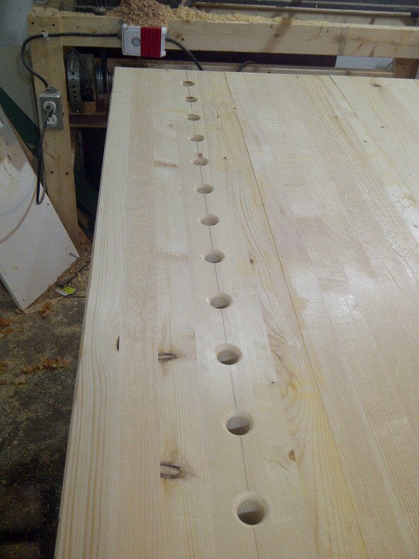

I marked out and drilled dog holes in one of the slabs on the drill press. Much easier than trying to get straight holes after the top is in place.

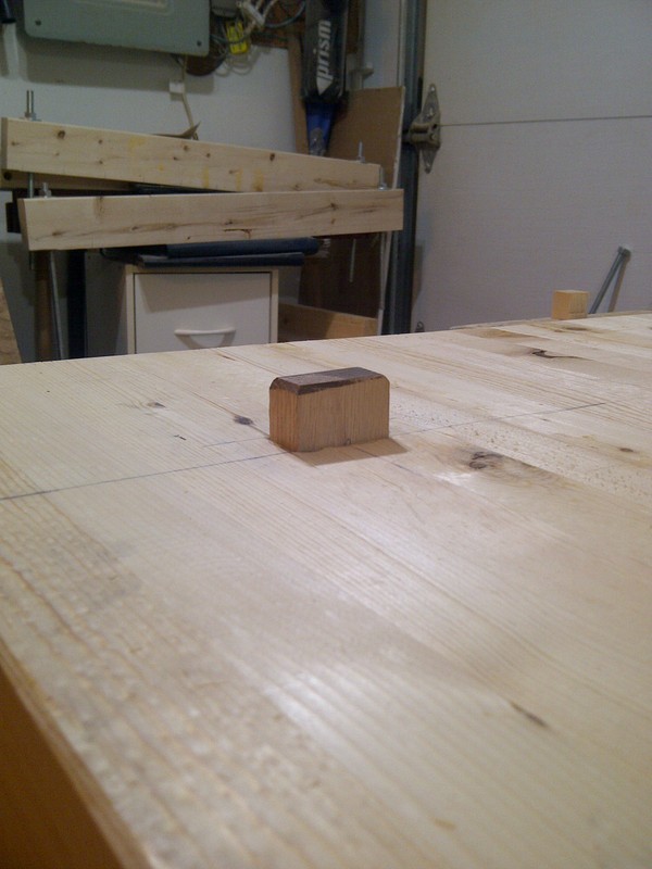

Once the top was on, I mortised in a pop up planing stop.

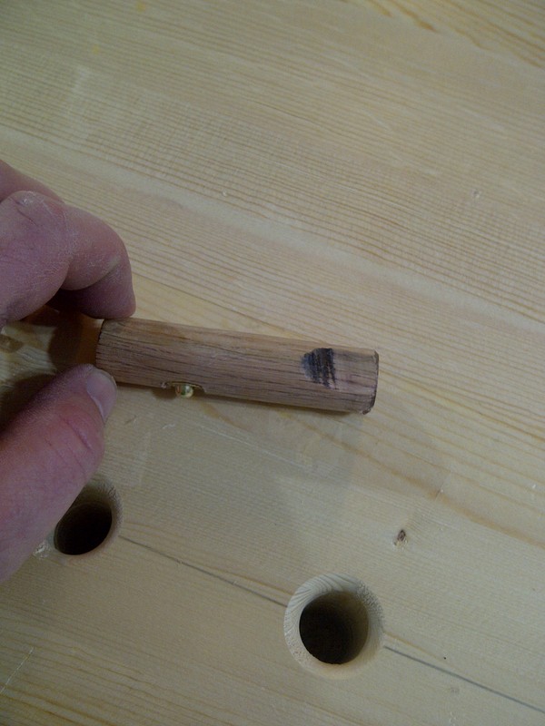

And some quick work on the lathe and drillpress, I made myself a round benchdog.
I will have to make a couple more at some point I suspect.

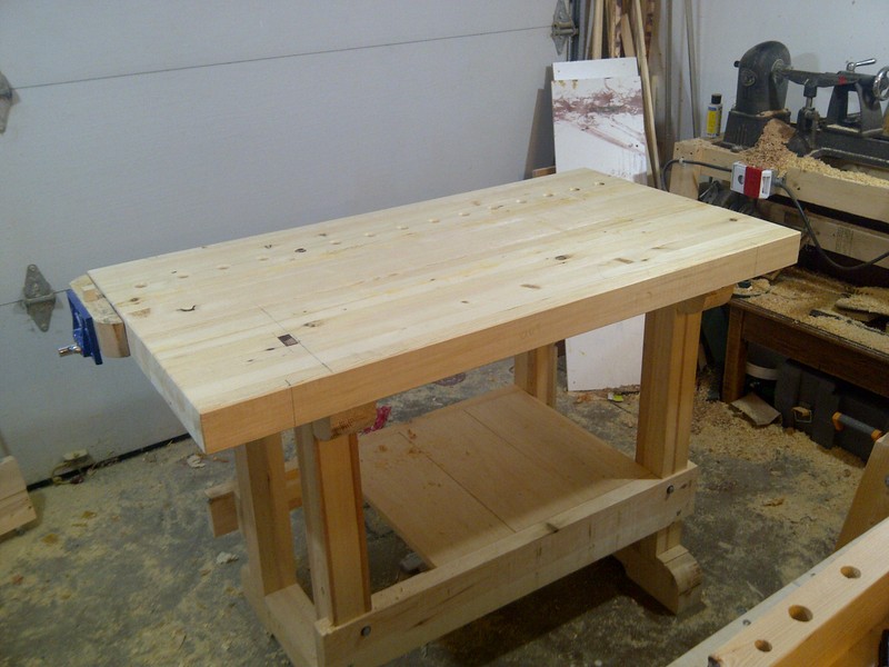

Just have to get some hardwood and a vise screw to make the chop for the leg vise and find a jointer plane to finish smoothing and flattening the top.
Don't feel bad about the hill-billy clamps and not Bessey's. I saved my money and went with dust collection in the shop so I don't drag it all in the house. I use the ones made out of pipes. As to your Delta planer, I just this winter changed out the blades I ran for six years. Learned that you have to have the in-feed/out-feed level or will get some *cupping* though.
