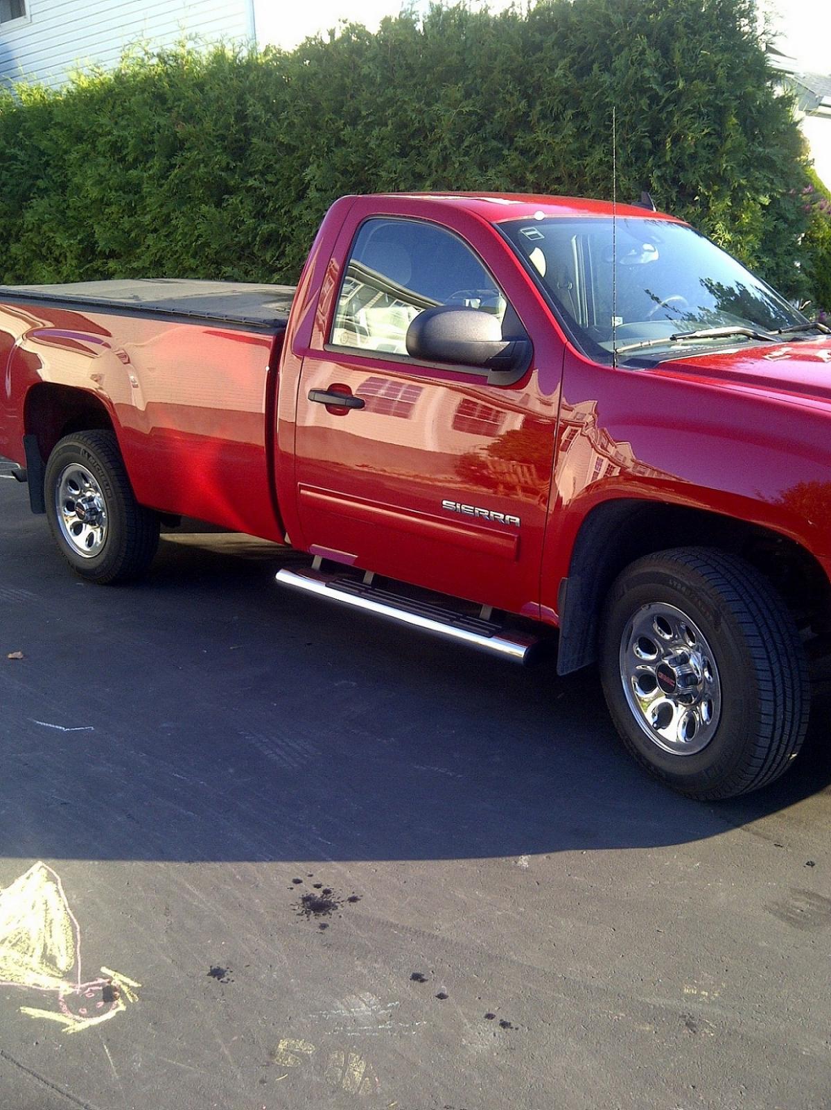

well I took a walk around the lot to get a look at how the different steps looked.
This is what I ended up with!
Looks good and you have the added protection they offer!
