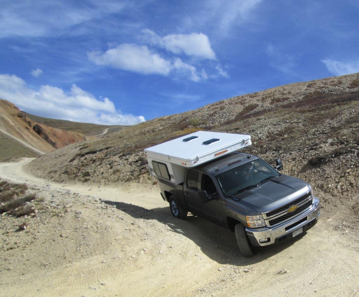

I like my camping in the wild, off road and away from campgrounds. My choice was a http://www.fourwheel....com/index.html
All aluminum, even lighter, and built for off road use.
