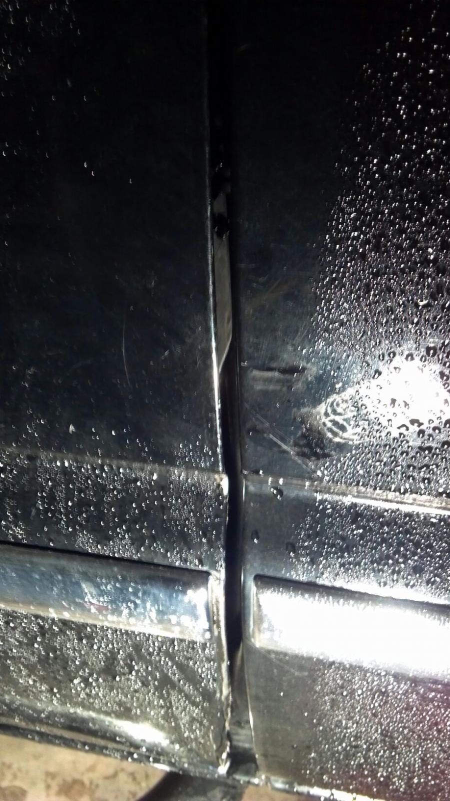

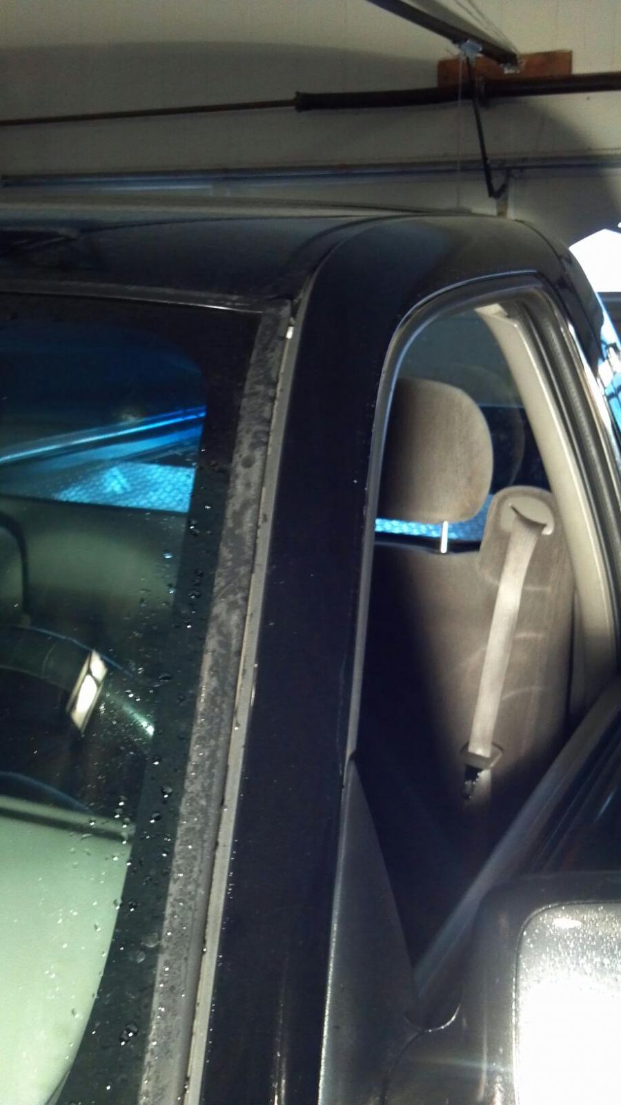

Picture 1 shows that with some more grunting and lifting, I pushed the door all the way closed this afternoon. Top trim looks like it fits ok

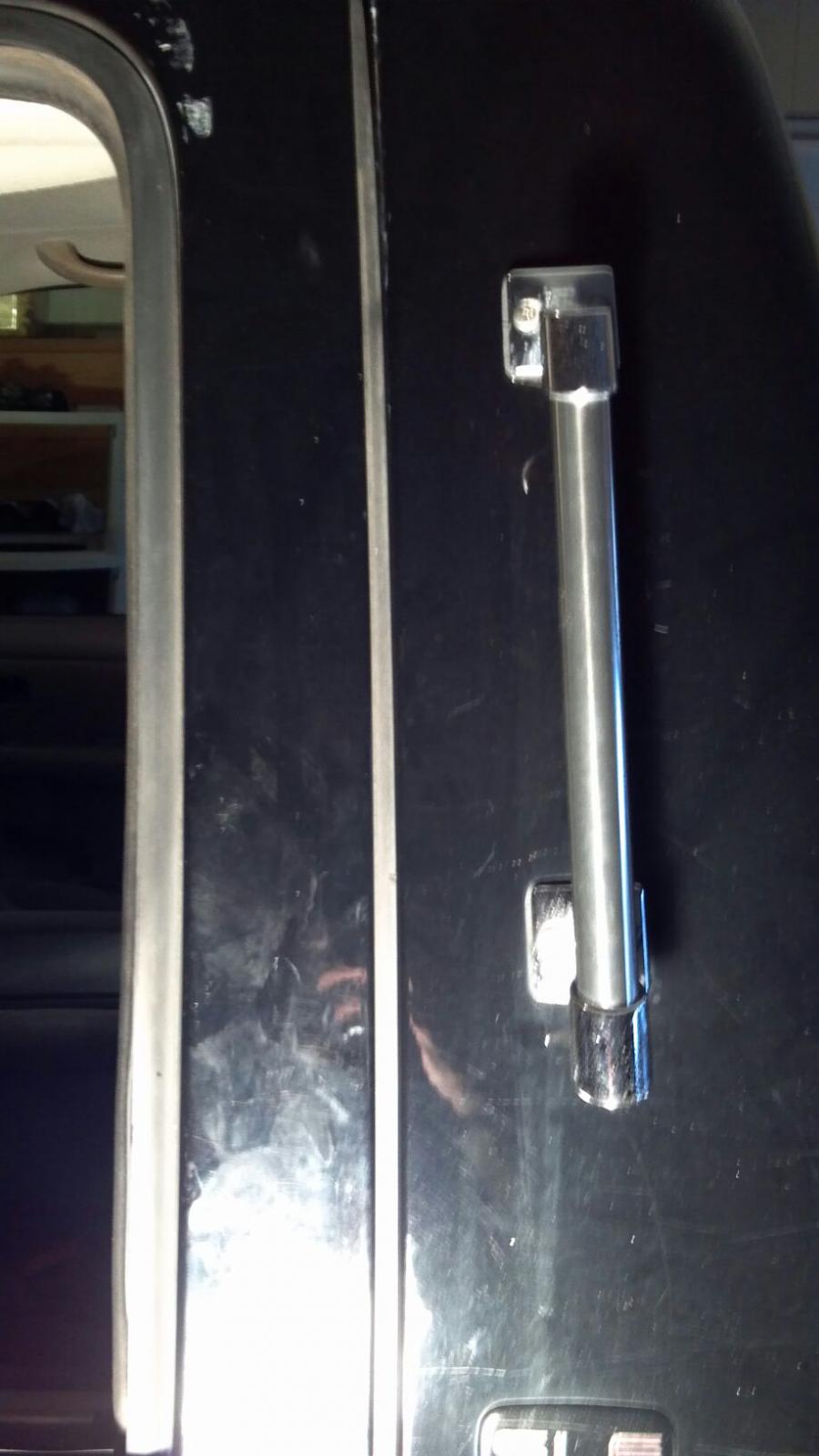

Picture 2 shows that although the door is completely shut, there is still a gap where you can tell that the outer door shell has been pushed towards the front of the vehicle.
(and it still rubs the fender edge, even though the door is shut properly) Also leads to hearing lots of road noise.

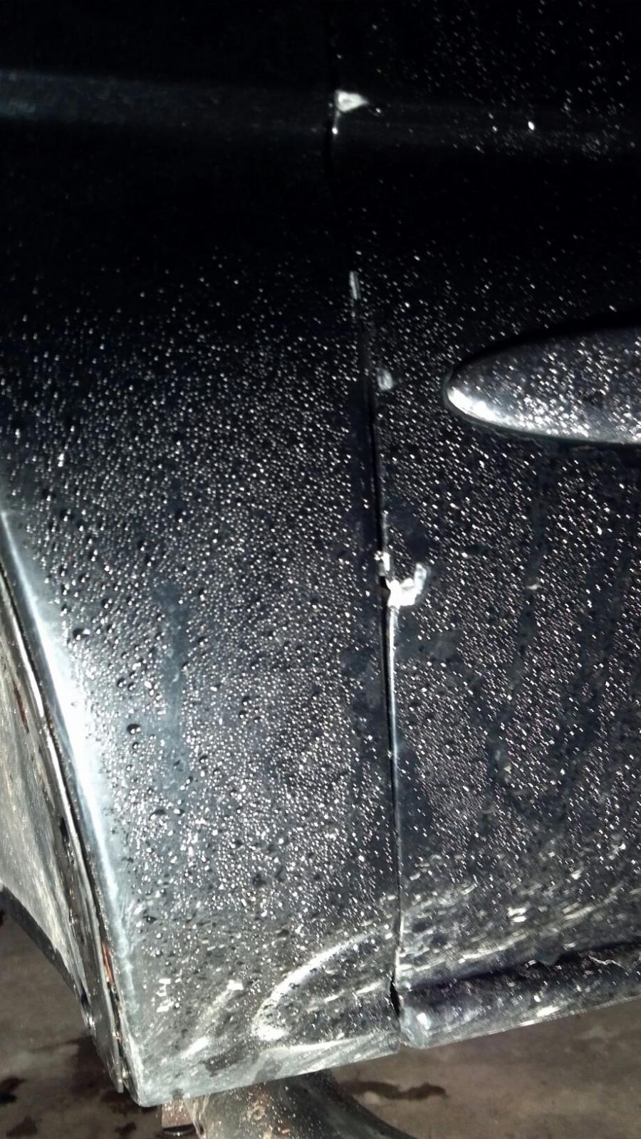

Picture 3 shows the fender in contact with the pushed-forward outer door shell.

hey david, good pics ! while the damage doesn't seem that bad, i agree with 06sierraZ71 that out of convenience and time the best way to go is if you can get that black door. hopefully with the stiff cab structure of the truck you won't have any issues installing the replacement and you'll back and rolling in no time as if nothing happened !. good luck, let us know how it turns out.
