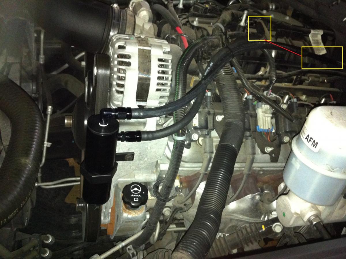

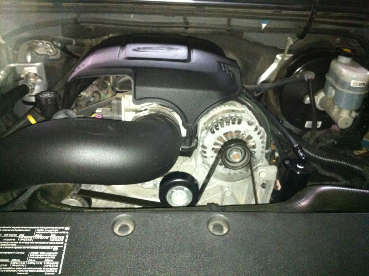

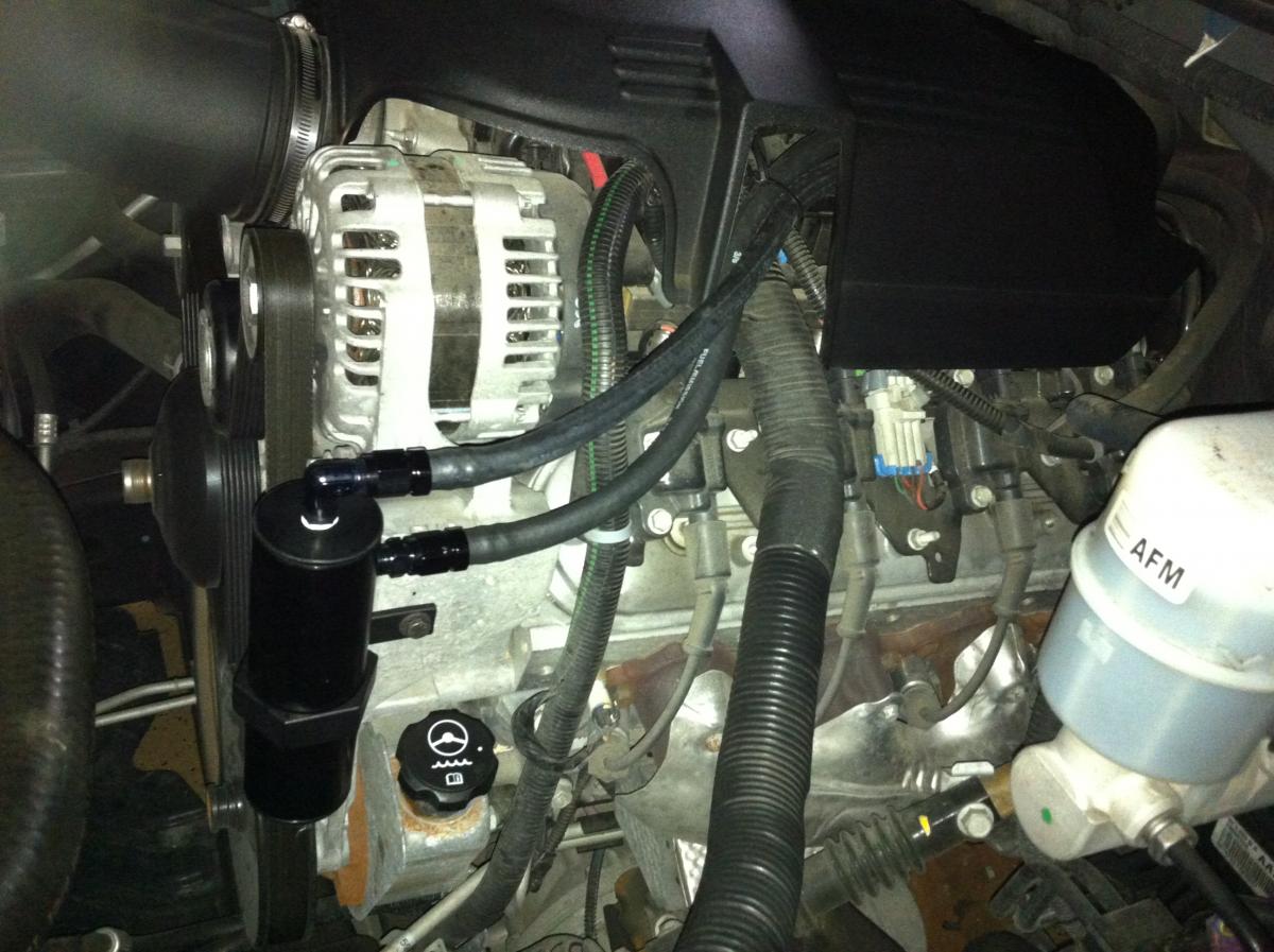

Installed a Mike Norris Motorsports catch can tonight.
Hey Ryan,
I bought the Jegs Catch Can / Oil Separator on my 2010 GMC Sierra All Terrain 5.3L, Where exactly do you connect the hoses under the engine cover. Can you please take a picture where you have it hooked up at.
Thanks,
Daniel
Hope this helps?
The red line is where the old PCV line ran. I cut this section out. The yellow boxes show where I connected the new hose to the existing PCV line that I left in tact.
