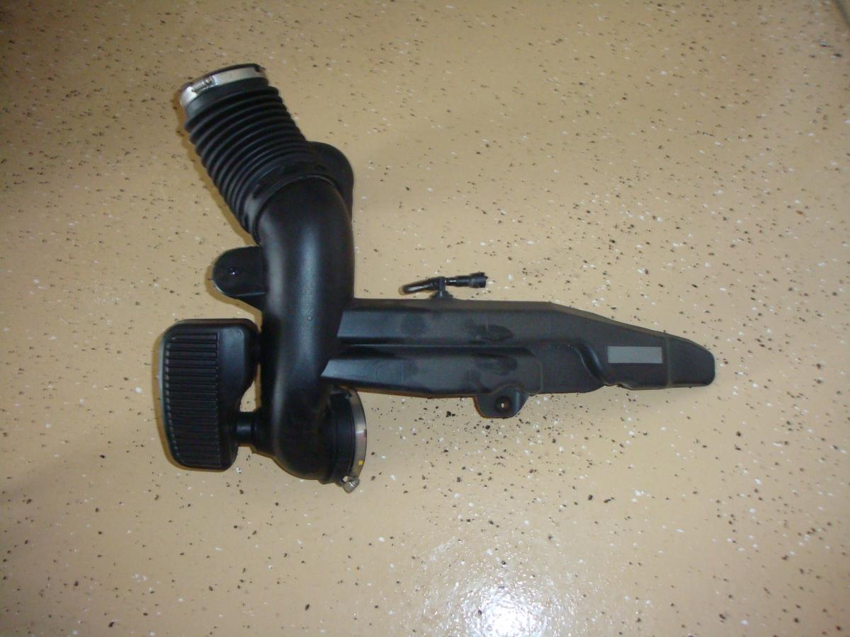

Ryan- What intake tube do you have and how much did it cost? It would definitly free up some space in the engine bay. I always wondered what the big bulky expansion box for anyways?
The box is for noise cancelation

The intake tube with all the growths on it is an excellent example of how to balance or cancel out resonance, without creating any negative air flow issues. Change just the intake tube with a new one from AIRAID, and be amazed at how well the stock intake cut intake noise down. The difference in sound is like how it was in the old days. We used to flip the stock air filter lid over on GM V8 engines to get the loudest intake noise you ever heard.
The airraid intake tube didnt change the overall engine noise very much if at all.
Just look at the stock tube removed, amazing any air flows through it
Hmmmm, I wish the air raid tube was a little less expensive. That seems pricey for just a simple tube that probably only provides aesthetic improvement. The intake set up looks simple enough, I could probably just make a streamlined air tube using specter after market parts If I really wanted to.
Just from looking, an 18" section of 3" tube, a 90 degree elbow, a 45 degree long elbow and some hose clamps would probably do the trick. All that might cost you $20 from your local autozone or advance auto. It probably would not look as sleek as the air raid but I am sure something like it would work. I will hold off for now though, I am really happy with my truck so far just as it is. I did the catch can to prevent problems and hopefully extend the longevity of engine not for the looks.
