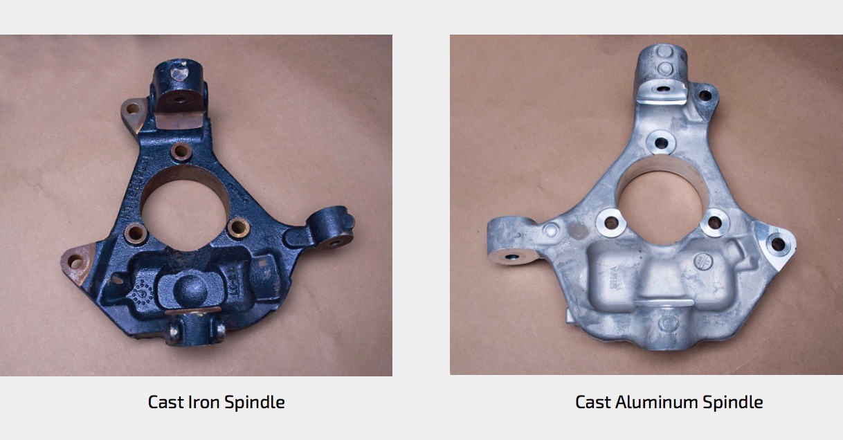

Djm is going to send me 2 ball joints to test fit to my,truck. Then I'm to let them know which one fits. Hopefully this will fix the 2016 djm issue
Are you saying they change the ball joints again? It was either aluminum or steel arms, now a 3rd option?
The 16 bjs are differant and there's 2 differant styles
It's not just the 16's - started with the 14's, aluminum and steel. I have a 16' with steel arms and according to all the literature it should have had aluminum.
Currently all new trucks should have steel as they were moving away from the aluminum arms sometime in the second quarter this year.
But 16s came with 2 types of ball joints. Regular and hd or some shit like that. I have no idea what mine are, even running the vin it doesn't say anything dofferant

FYI....I would upgrade the ball joints from the start, even though they list a Moog part number as the replacement, they do not install Moog ball joints.
I have done a little research. The 16s come with 2 dofferant sets of steel control arms. 1 is hd avv stamped and he other is gm 25812725.
They are both easy to tell apart. So I sent this info to djm. I'm just waiting to hear back
Can anyone confirm iron or aluminum control arms on the 2016 Z71 silverado? Looking to order DJM Control arms today and not sure which variant to order.
Mine are stamped steel welded together. 2016 LT Max Tow
