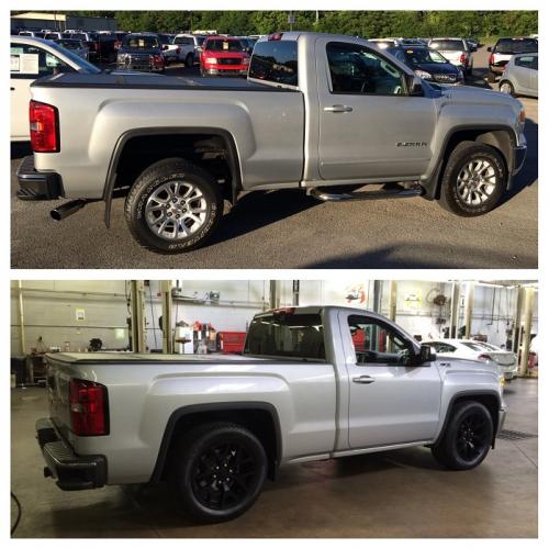

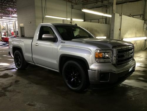

Got some time to tackle the DJM 3/5 drop this past weekend. Already had the Mcgaughys 2/3 drop on it. Lots of work but definitely worth it! Very happy how it turned out, the truck drives great. Also finally got the Ranchos and shock extenders off the rear and got some Belltech Nitrodrop 2s on the back. Got a bunch of additional install pictures i can post up
pretty cool before and after shots. Not a bad transformation for 3 months since I got it
Looks great DanHamilton. Are you 4x4? How does it ride now and how are the front axle angles now?
yup it is 4wd. Angles are perfect, 0 vibrations and no clearance issues. Only thing I may add is Belltech camber adjusters. The DJM upper arms compensate for the camber but it doesn't leave you enough adjustability to get the caster and camber perfect. Camber is set to spec but caster is just a bit off, equal side to side so there is no pull but being the perfectionist I am I want it to be dead on. Fine for now the truck drives great, felt alittle looser and more prone to wheelspin but I was also about out of fuel. Filled it up but haven't driven it since
