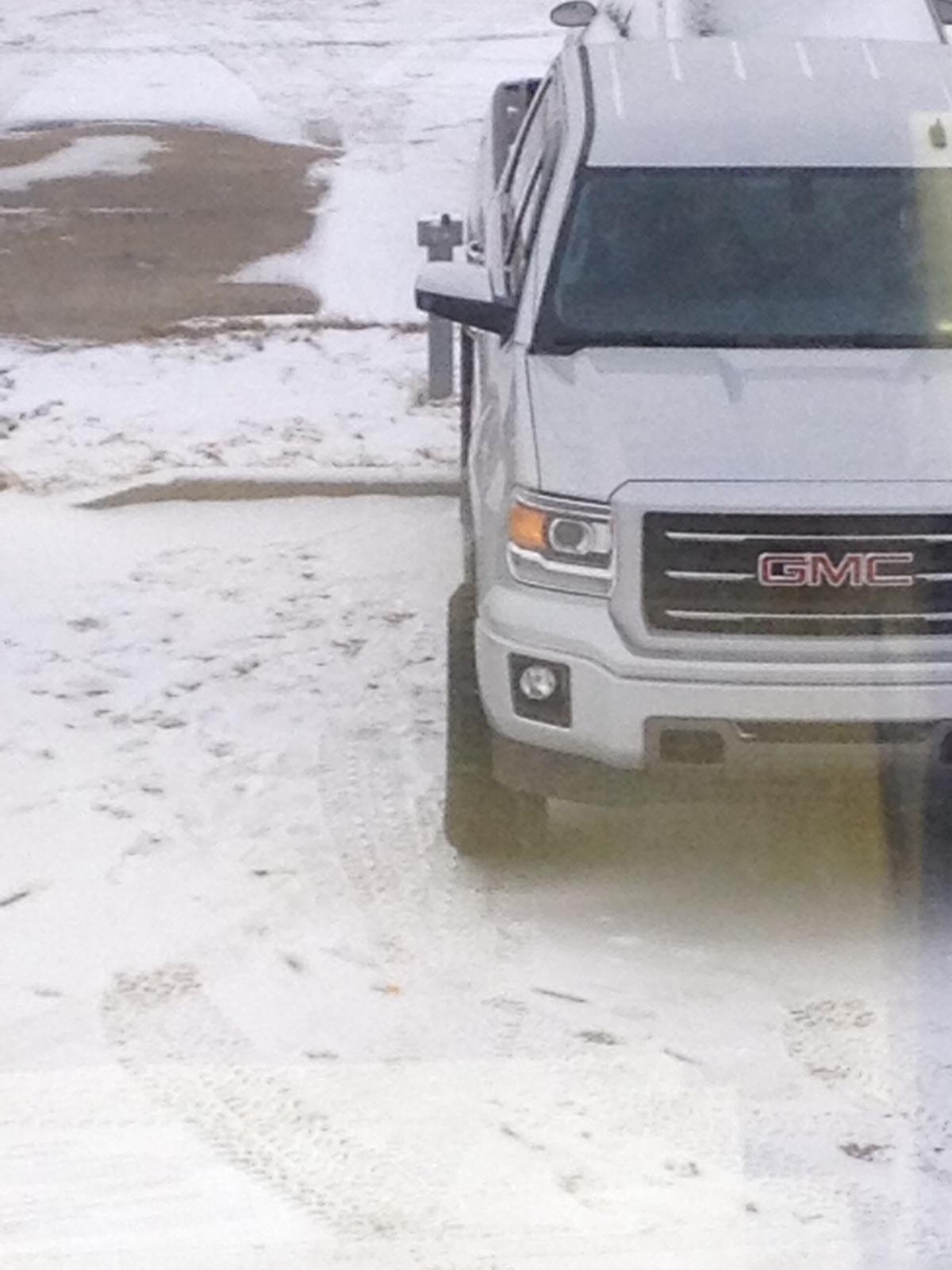

Finally got my new truck yesterday. Pretty happy with it. Being OCD sucks especially when now there are two more things to set ( telescoping steering and moving pedals) ha ha.
Anyway, I took a couple quick pictures. So the run down is:
18 x9 Moto Metal rims with 0 offset and 5 inches of backspacing as per BDS suggestion, 275 65 R18 Durotracs, 4 inch BDS lift. These tires are about 32 by 11.
I could have put 295 65 R18's on I am pretty sure but I wanted to be sure of no rubbing. And there is plenty of room everywhere. Not even close to rubbing with what I have.
Going to try it out to see if I may need fender flares. I don't want them but the front tires stick out about two inches from the truck.

Awesome, looks sweet! Did they use spacers in the rear so the front and rear tires lineup? How does the ride compare to stock? Any vibes/shakes? Would be great seeing pictures from the front to see how far the tires stick out. What is the approxiamate cab height. I park in a parking garage at work.

I didn't get spacers on the back. I never thought of it and as it sits right now the back tires are pretty much under the wheel wells still. Like I said, I really don't want to put those big bushwacker flares on it so keeping them tucked in helps. I am hoping someone will make the smooth style flares soon similar to the 2006 style factory ones.
After a 600km day, I have learned how much mud the front tires throw up onto the side of the truck. i had to stop and clean the mirrors so I could see. Not liking that part but may just live with it :)
I will get some more pics of it from the front once I wash it. Right now you can't even tell it is silver ha ha.
Don't know height yet. Got home from the dealership at 9 last night, had to throw all my work gear back in and get up at 5 this morning to go. Will pass it on once I know though.
I never drove it stock but I know it rides nicer than the 2010 with a level kit and new Rancho 9000 adjustable shocks I just traded in. The mechanic that put the lift on said it drove like stock.
I did notice a slight vibration at 120km per hour today but it felt more like about a 1/2 ounce out on a tire more than anything else. With aftermarket wheels and stick on weights I sort of expect it.
At 110 km per hour for six hours it was perfectly smooth.

Took a couple of pictures to show how far the front wheels stick out with this combination. I am thinking I am going to put on some wider mud flaps to help keep the mud off the side of the truck. A little at least anyway ha ha
Ok one picture is apparently too big.post-125934-0-54686300-1391052291_thumb.jpg
Dirtbiker, how much space to you have between the back of the tire and the bds spindle? Do you think an 18inch +18 offset (5.5 backspacing) rim would work? That would move the tire in about .7 inches. I know BDS recommends 4.5-5 backspacing just curious if a postive offset could work, help suck the wheel in a bit.
