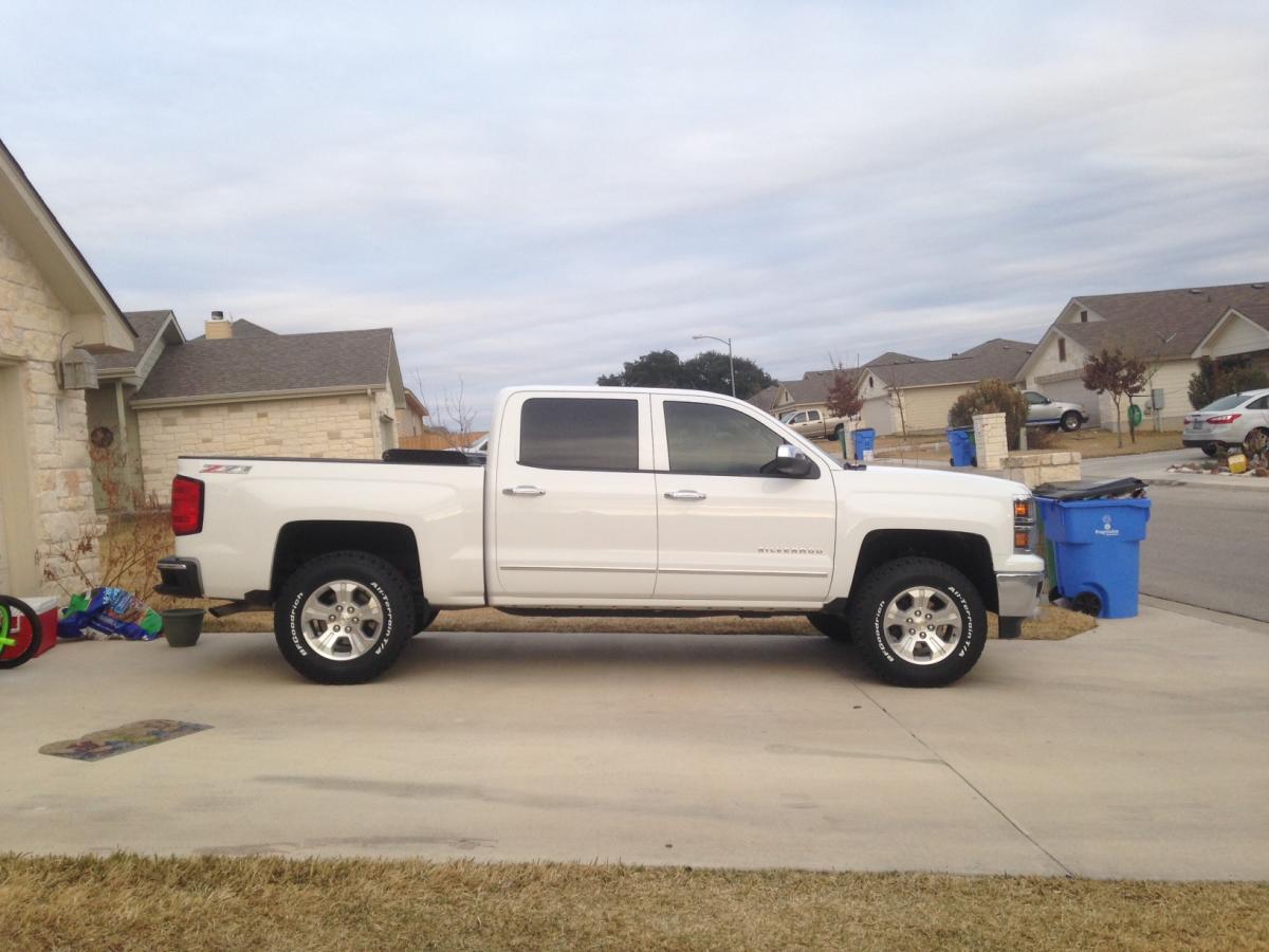

Here's mine after a 2.5 inche RC lift and 33 inch BFGs.
Truck looks great DH!

Thanks TXGrantDuke. I love the way it drives, wasn't happy about the mpg loss, a little more than I expected, but 16-18 still isn't bad. Now it's time for assist steps and bed lighting!
I also like being able to pull up next to a Ford and look down on them.... I hated it when a Ford is taller than my truck.
