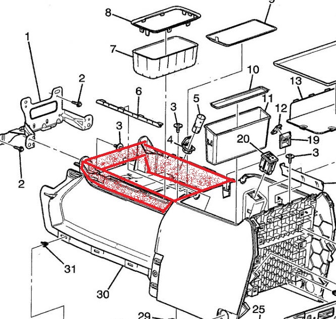

Does anyone know how these trim pieces come off? I was able to get the pieces on the front doors off but I can't get the back doors or the center console ones to come off.

For Double Cabs like me the numbers the last two numbers(rear doors) will be:
LR 22837214
RR 22837202
And for the full center console trim plate which contains both trim pieces:
22995085
Yeah also the "reverse tartan" trim does not exactly match the front metal trim on the dash. I would call it more of a silver carbon fiber look.
See attached pic. The area in red is all one piece, consisting of usb/power panel, top side rails, and plastic panel running in front of console. Remove by prying up corners closest to center console, working your way forward. You'll have to unplug back of usb/power panel items to remove completely. After you do, flip it over and you'll see the tabs holding the wood trim in place.
