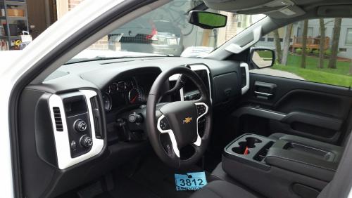

Here's after dipping, though I used flexidip - 1st time I've used and for this application it was nice because the texture is harder vs rubbery feeling :rollin: .
Looks a lot lighter in color than the OE trim. What color did you use? Was it just "gray"?

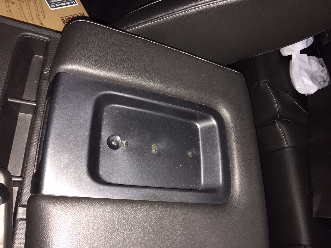

Does anyone know how to remove the top of the Console/bench seat? Sending my interior pieces off to paint and would like to get this painted too.
