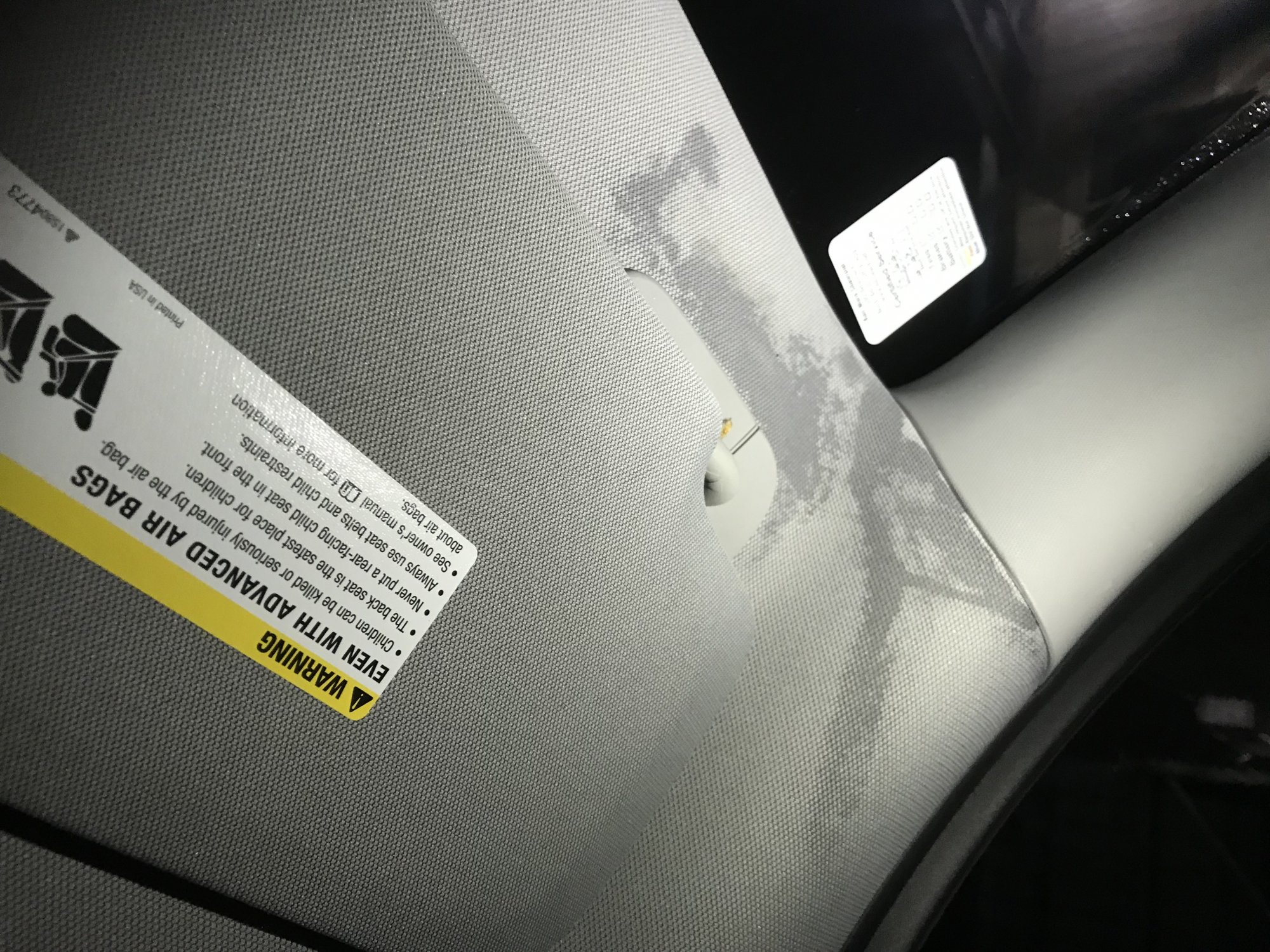

Last night I climbed into the drivers side to find my 2016 Tahoe LTZ to find the seat soaked, as well as the steering wheel and then felt drops on my left leg. A ton of water was dripping out from between the windshield and the visor. I had to get somewhere so I drove like that, water pouring all over me. I could hear sloshing at one point. Wasn’t sure where the noise was coming from because it was dark. I read up and searched YouTube when I got home and found out about the issue with the antenna. So I dried off the roof, covered the antenna with plastic and sealed it up for the night. It also rained yesterday and this didn’t happen. Odd it happened so suddenly. Also, my driveway is flat. Thought it worth mentioning. I left the car running with the heater blasting after I sealed it up and got it mostly dry. Nervous about taking her in tomorrow. I just know they are going to look at me like I’m dumb and say, “did you leave the window down?” or something like that. Any news on if this is a recall issue yet?

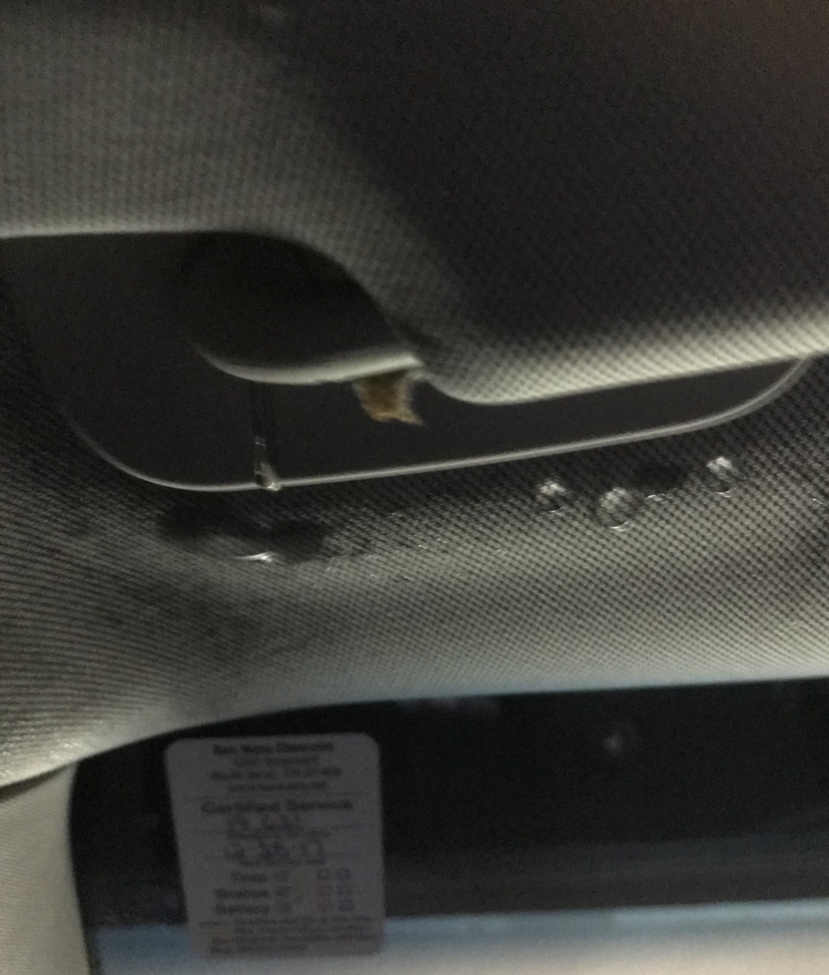

So, I was driving yesterday and it was barely raining out and suddenly I have water dripping from the passenger side of the overhead console.  Mine is a 2014, no sun roof or anything and now there are water marks on there.  50K miles so out of warranty, was there any type of recall for this?
It's the XM antenna. Mine has been replaced 3 times. The last time I was told that's an updated gasket.

Thanks, how long did it take and how much was it?  Not sure why my last post was so small...
I don't know how much it was since they were all covered under warranty but it only took a day. I think they drop the whole headliner and the entire antenna gets replaced

Did the headliner look messed up at all when they put it back? I’m nervous about getting mine fixed. Driving around with it sealed up on the outside for now.
