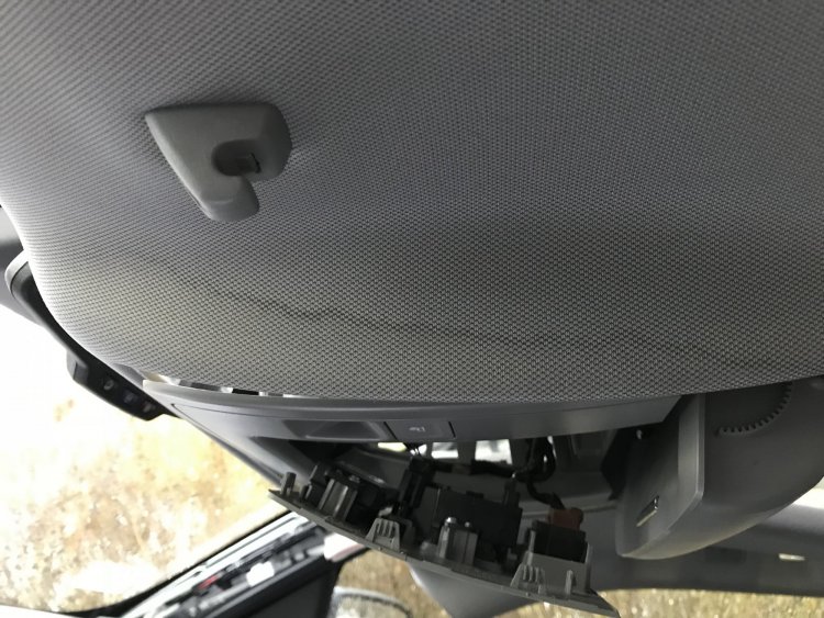

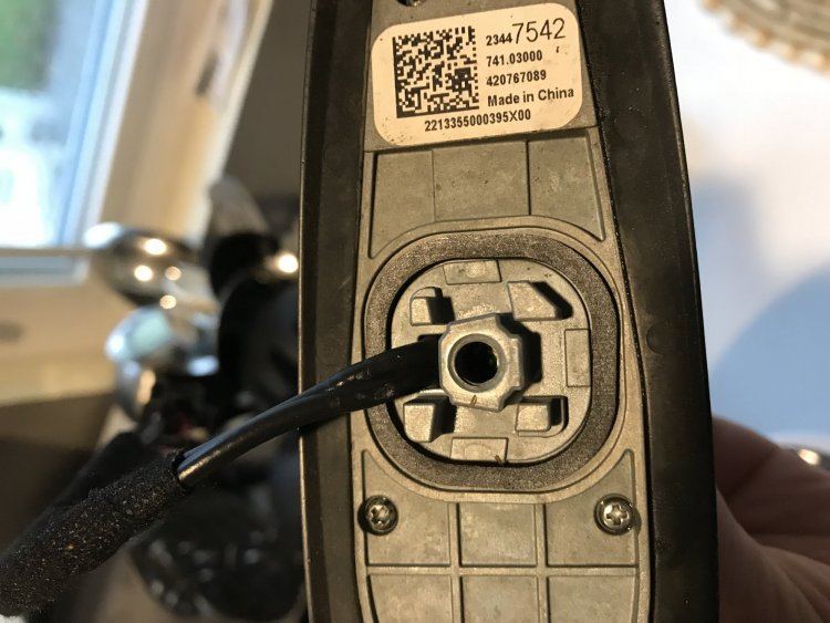

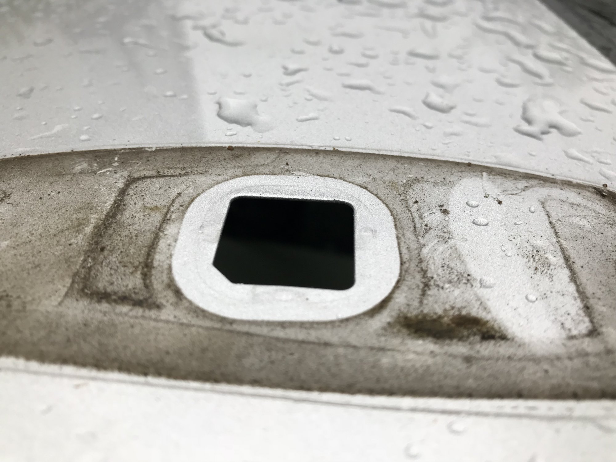

long story short and pulled headliner down and poured a bunch of water around the sunroof as my wife was watching and nothing. Then I moved to the antenna and bingo. Drip drip drip

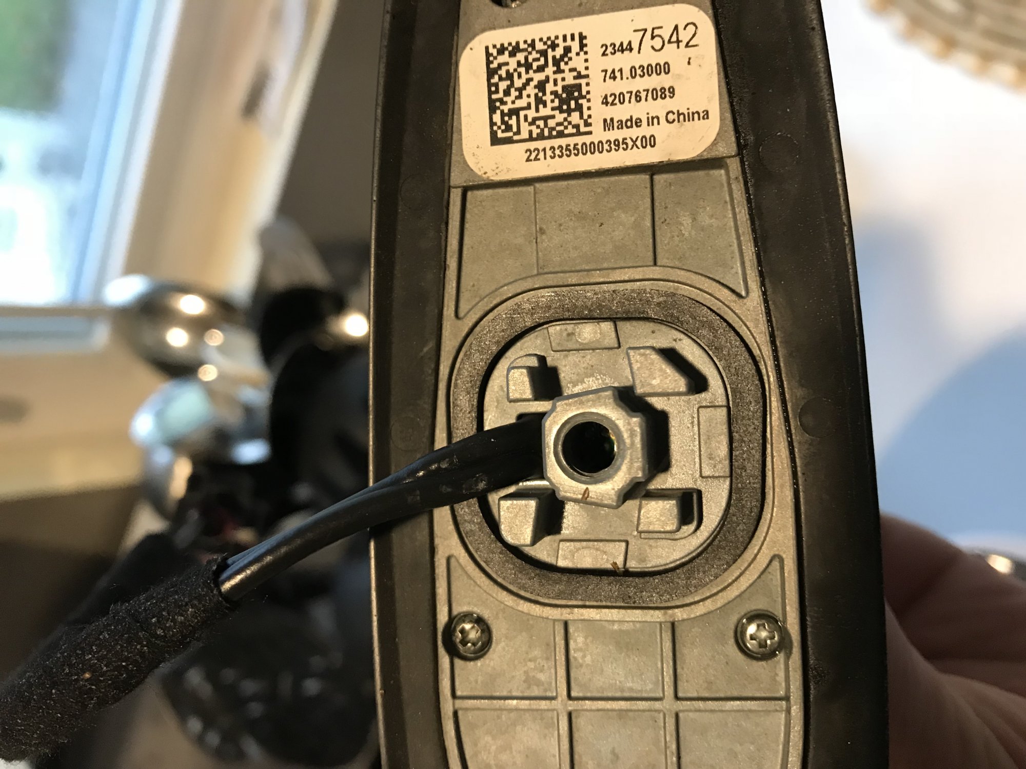

i pulled the antenna out but nothing looked to be bad with it? Im gonna clean the roof off and the gasket and tighten it nice and good.

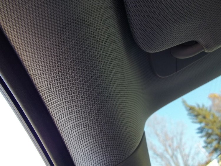

I noticed a water stain on the headliner just above the a-pillar trim (which also shows signs of being wet) and then water droplets are visible from below the a-pillar where the dash meets up to the weatherstrip.  Also had a puddle of water on my WT floor liner.
So far the headliner has not been wet around the visor mounts  so thinking it's not from the roof-mounted antenna, or could it be??

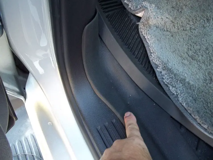

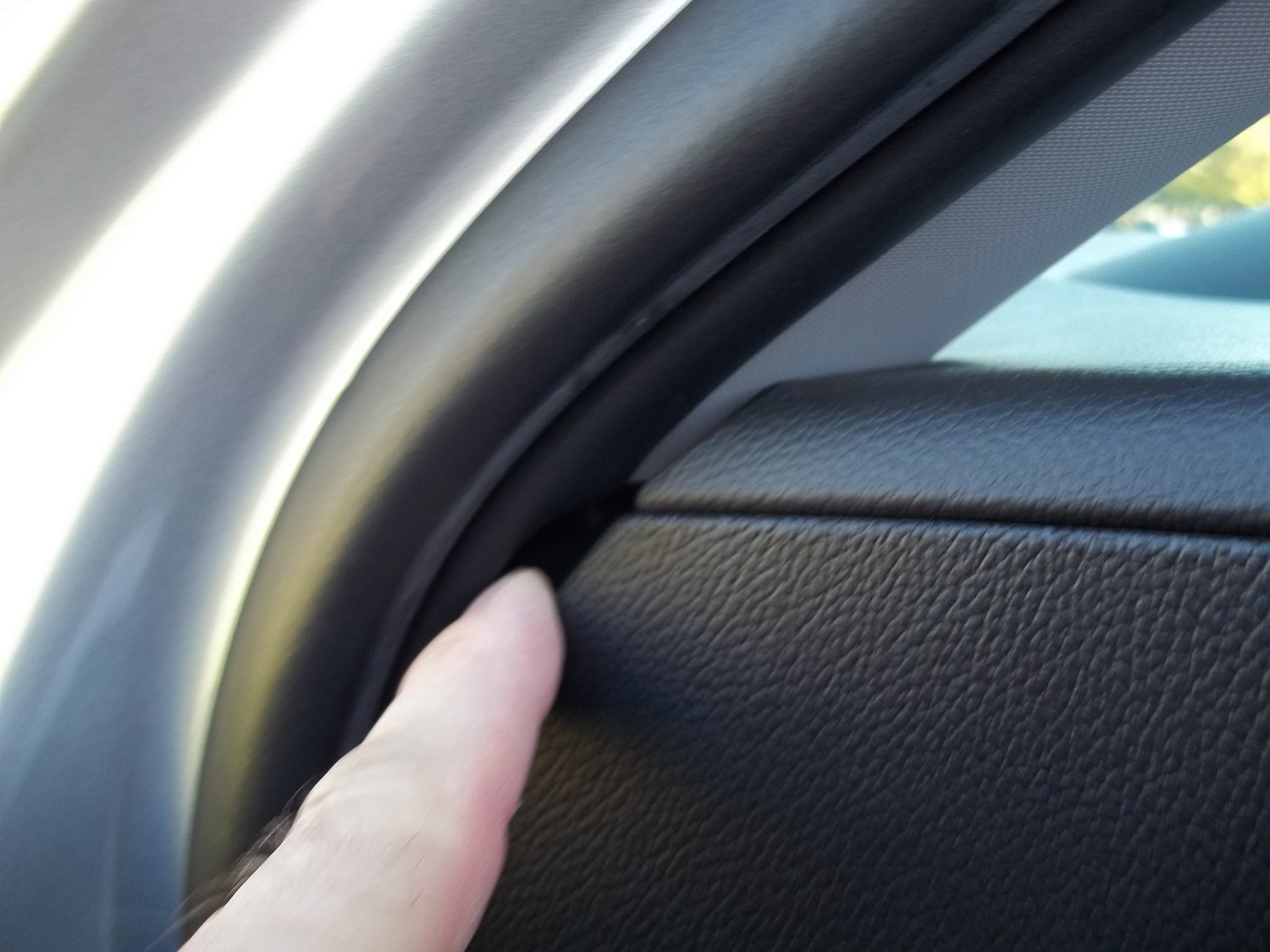

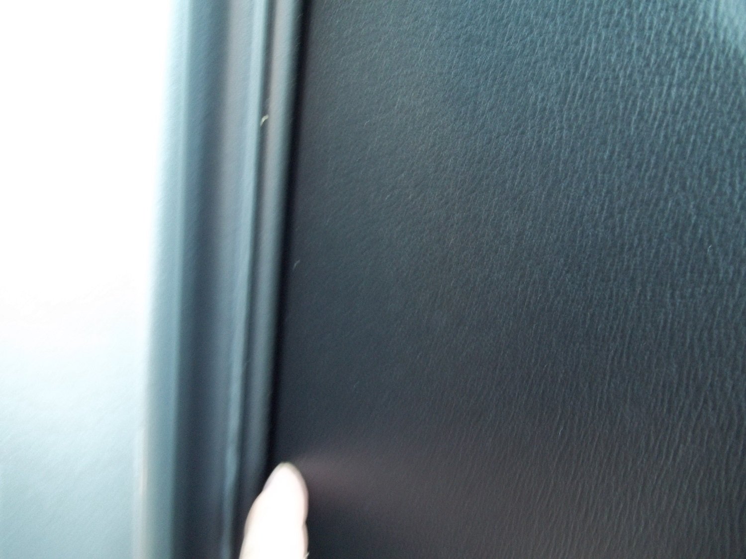

In addition to my post above, here are some pics.
Unfortunately these were taken after the water had dried.
Finger pointing to where the water was at the base of the a-pillar trim, along the dash plastic & weatherstrip, and on the floor liner where the water collected.

To update that the shop replaced the antenna with a new one, with the gap in the gasket facing forward unlike the way it was originally facing to the rear of the truck. So far no leaks.
I looked at several used and new late model Chevrolet & GMC trucks on their lot and some had the gap facing front, some facing rearward.  All the new ones went forward as it makes sense to be able to have any water drain down and out!
