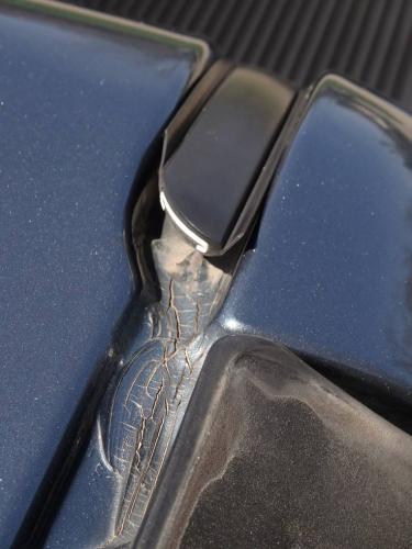

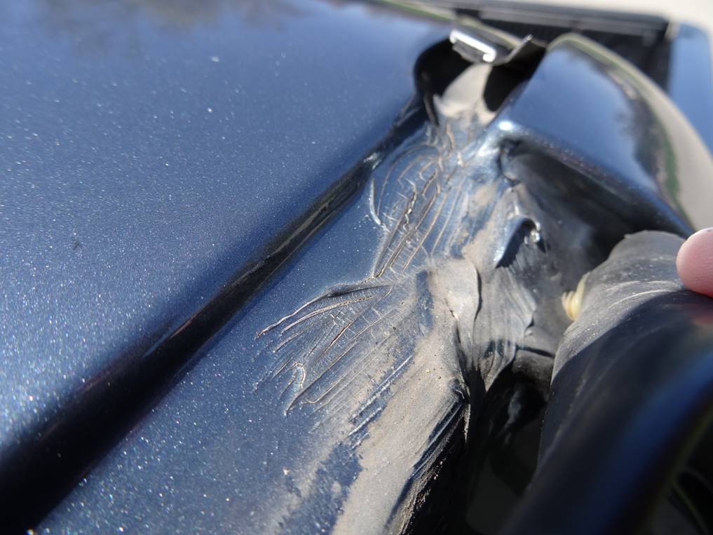

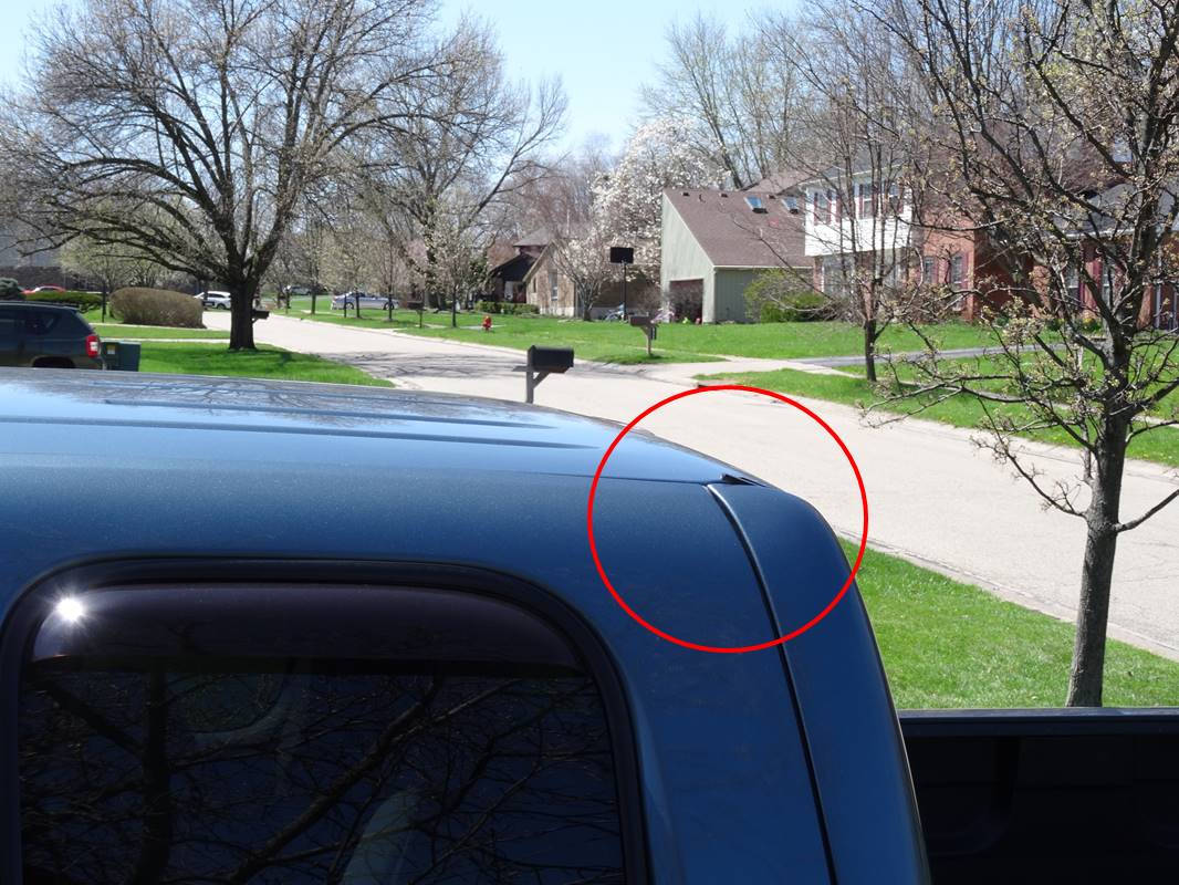

All Sierra owners, please check your trucks....

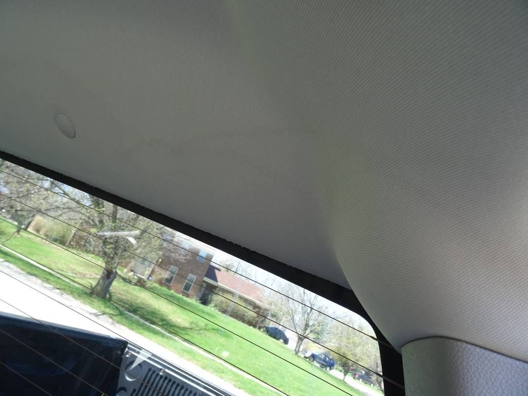

I found my leak today. For a long time I have noticed wet carpet under the driver's side floor mat. Never could track it down, until now. It wasn't terribly bad.
It just got significantly worse. Saw one small "water trail" on the inside of the rear window. Upon further investigation, found this:
Off to the shop tomorrow. I have a funny feeling this isn't going to be fun. Passenger side is heading down the same path, but so far dry.
Notice the staining on the roof liner. That is new since a crazy rain storm this past week.
