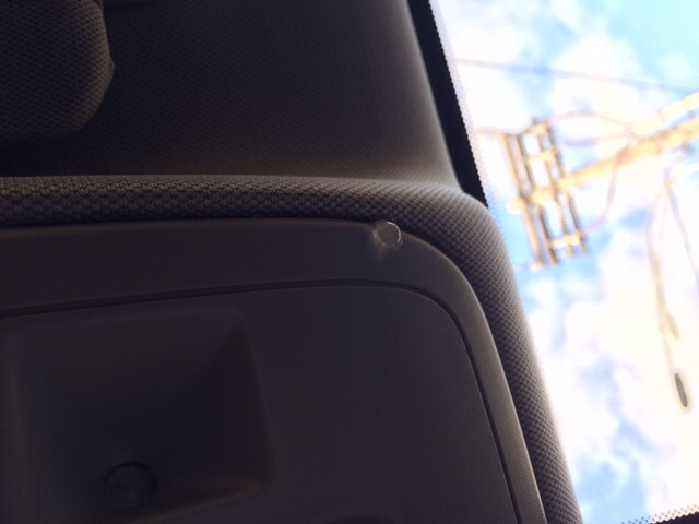

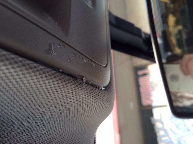

Recently had water come in at the console above the rear view mirror. Came out at both sides of the console. The service dept said he had seen others when I asked. They are having a water leak company look at it. I want a full report on what they find. Not cool to have water coming inside a vehicle. Who knows where it's going!?

Hi, what year is you truck / build date? And did you notice the water come in after a freeze, that seems to be when I get mine. If it rains than freezes and than rain afterwards I get the water.
Yes, please get a full report of what they find and how the actually fixed it. Don't settle for the "oh we just replaced the gasket or something" The gasket on this is not servicable and I am thinking the dealers are fixing them with silicone.
I posted above that there is a newer part number for the antenna. Get that info as well, what antenna was in your truck and if they replace it, what what is the part number of the replacment. I can't find any info on why the numbers changed.
