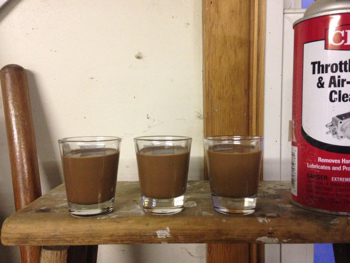

or like this amount out of my catch can at around 6000 miles......
Thats nuts. Like i said, iv only had mine on for a week and when i checked when i got to my parents house, oil was already dripping out of it. My question is.... now that most of the stuff is being caught before going into the intake, what will happen with the stuff already in there? will it eventually burn up over time?
yeah, what is already in there has caused whatever mischief it is going to cause. I am sure that the valve stems and intake manifold don't look ideal, but if you have no problems now, at least by stopping more of it from happening by using a catch can, it will make all the difference of a potential problem happening in the future. Seafoam spray shot in thru the intake tube at the throttle body could make a difference in cleaning some of it up, but the only way to get it all out of there is taking the intake manifold off and cleaning it. I wouldn't worry about it at this stage. The Seafoam spray method that might be worth doing.... inserting the hooked spray tube in the boot area where the throttle body is and doing a major clean thru the throttle body into the intake. Just got to find a way to keep RPM's at 1000 - 1500 for it to distribute properly throughout the intake.

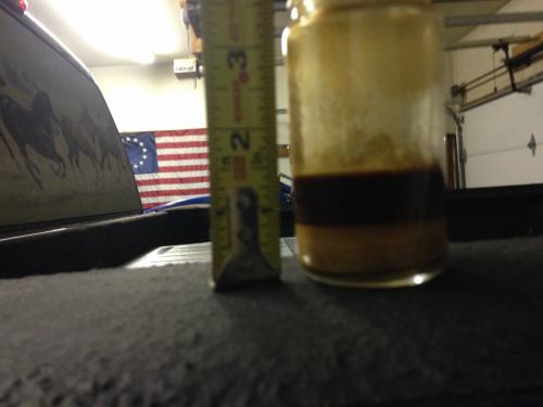

Figured with winter upon us, I would show what my catch can setup has captured in 1000 miles. That milky condensation junk sits on the bottom with oil on top of it. Makes one feel sick that it could be in the intake, coating the valves, and making a mess internally. Oh, the setup is a Conceptual Polymer standard unit for the primary (left) and a Conceptual Polymer High efficiency unit for the secondary filter (right). The capture bottles are 2" wide by 4.5" tall
That's how mine looks too it's nasty thick stuff

Yeah the jars almost take something like MAF or Throttle body cleaner to get the crud out of there when I dump it. I have a hard time imagining that for years on other engines, I didn't even think this kind of thing was going on internally. Am sooo glad I made this mod within 1200 miles of owning this ride.
