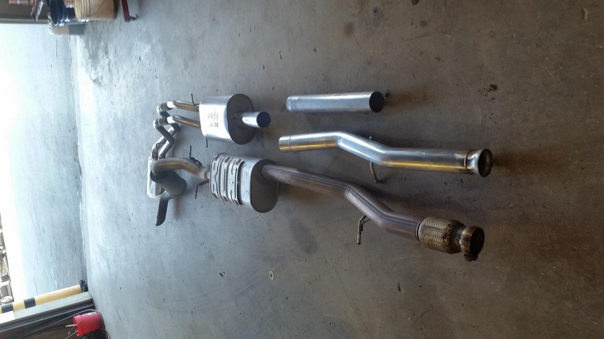

Just finished installing the GM-Performance Borla Split pipe system. Pretty easy to do but a pain in the ass without a lift. Thanks goes out to Fondupont for providing sound advice. Will post pics later once I get my shop cleaned up.

i Checked all pipes there, mine came from Borla its different then the GMPP setup that the dealer sells

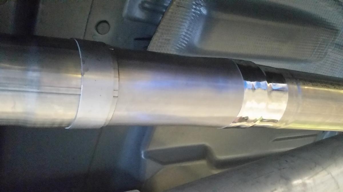

OMG!!!!!!!!!! took about 15mins. Well Im not a engineer or a car guru but I didnt think that i would gain torque or HP but it did. Idk if its because of the airflow or the exhaust or both
It is way more responsive and felt like it shifted a little easier,definitly notiecable tho. ZERO DRONE in v4 and there was no sound change switching. I thought it would be louder but it definitly has a deep growl and is pretty loud at startup in garage, in the cab with windows down my sons and i had a normal spoken a conversation. with foot off the pedal you could barely barely hear it. 4000+ rpm you can still hold convo. Video I have on youtube is a hot start, i was worried it wouldnt be loud enough or too loud, but it is perfect. havent noticed any change with active noise cancellation or if it even effects it in any way. its quiet til bout 2000rpms then the tones start coming alive. I would highly recommend, i had my doubts, but 100x better than i expected. . amazing smooth and subtle at low rpms. The neighbors may not like the start up from echo in garage, and is loud if you get on her, but normal driving is fine and dont think cops would give you a look, but watch out if you hit it lmao, heads will turn
