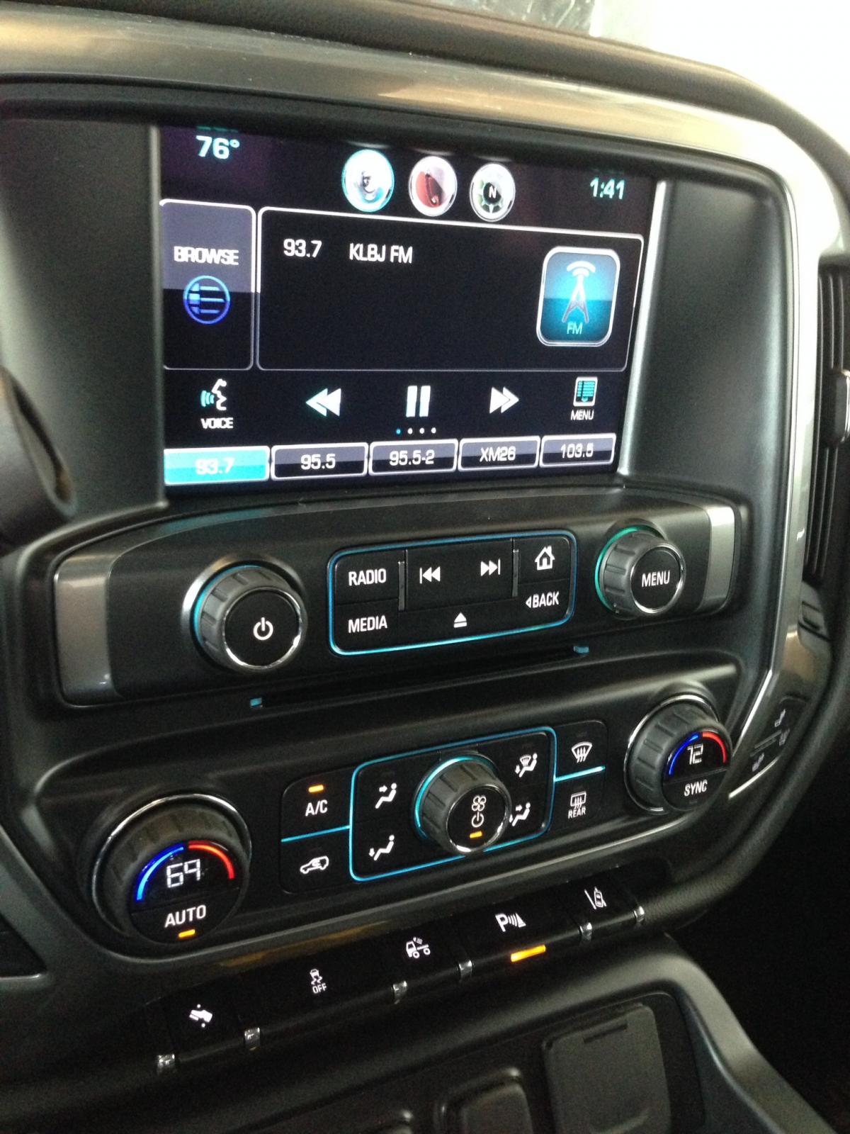

I'm seeing more and more of you guys are getting the led lights fixed behind the radio knobs and hvac knobs. What exactly are you telling the dealership? I've tried saying everything, I've even take the brochure and showed them what it's supposed to look like but they keep telling me it's not done. I'm just curious.
Bottom line is some dealers will do it and others are following the GM policy document saying not to fix it because it was a running change. My dealer did mine for "customer satisfaction" but it was before the policy document - they showed it to me right after they fixed it.

The round radio knobs and fan knob on the HVAC should be illuminated just like the headlight control knob on newer builds. See pic below.
NOTE: it is the BLUE lights only on Silverados, not RED Sierra - Sierra were all made with the appropriate control knobs illuminated.

Yes, that AND the original sales brochure as well as the MyLink guide show the lights on. These are what I showed to my dealer's service manager in hard copy form. If you don't have an original copy of the 2014 Silverado brochure, you can get a copy here in PDF form: https://www.chevrolet.com/content/dam/Chevrolet/northamerica/usa/nscwebsite/en/Home/Help%20Center/Download%20a%20Brochure/02_PDFs/2014-silverado-1500-ebrochure.pdf
Chuck did they just order a new bezel for it? How did they fix yours?
They ordered the control panel for the radio and the control panel for the HVAC - two parts/boards.

THIS IS A SILVERADO ONLY PROBLEM. SIERRA WERE ALL SHIPPED WITH APPROPRIATE KNOBS LIT! I see that you have a Sierra...if your trick's control knobs are not lit, there is another issue.
Oh. Well then haha. Yea mine aren't lit. And I do have a sierra. Wonder what could be the problem then.

Sounds like a trip to the dealer. The Silverado issue is that some early builds did not have the appropriate control knobs illuminated from manufactoring, then later they shipped with them. They called it a running change.
